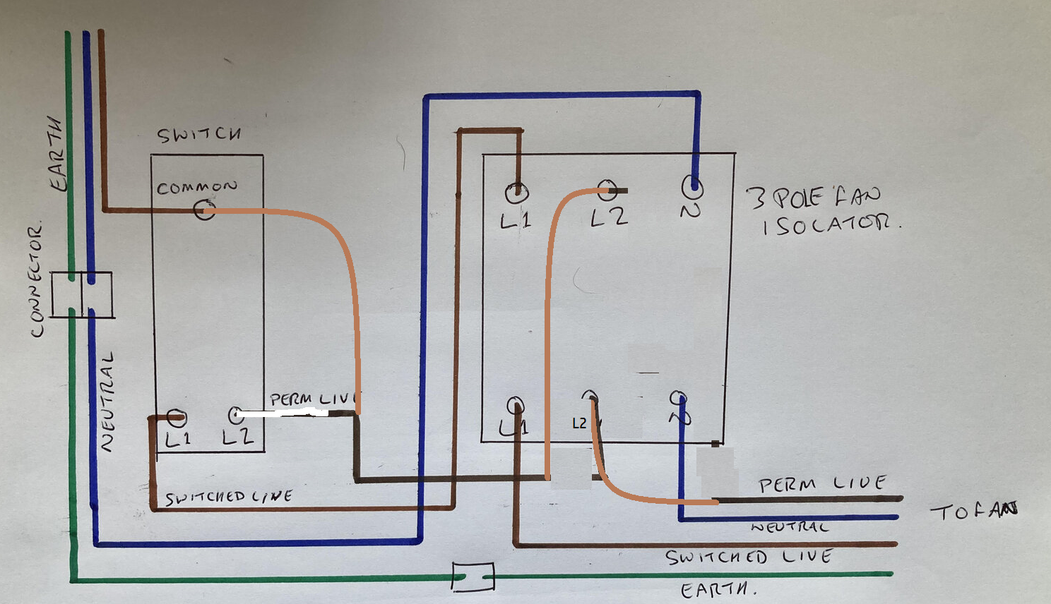

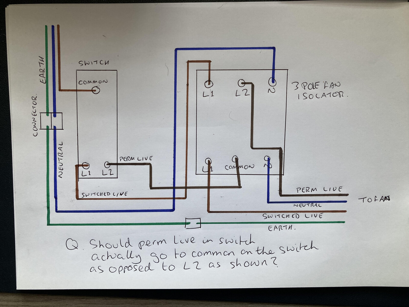

Your comment about L2 above has made me rethink my wiring to the bathroom fans. These have all be run in with new 3 core and earth cable and a new 3 pole isolator. I have followed the instructions for wiring the fan and switch to the isolator, but I believe I may have the new permanent live feed in the wrong connector at switch end. At the switch I have live coming in which is connected to common. The switched live is in L1, and then I have connected the new permanent Live to L2. Should this new permanent live actually go to the common, with nothing in L2. I attach a coloured wiring diagram showing the cirruit wiring. Hopefully someone can advise if I have done it correctly. Thank you.

It depends what you are talking about.
On a two-way switch both L1 and L2 are switched lives, but
on the isolator L1,L1; L2,L2 and N,N are just the markings for the three conductors, each of which switches on and off whatever you connect to them.

It is a one way switch. The fan is designed to be permanently on. The switch is used to boost the fan whilst having showers etc. Once finished you turn off the switch, and after an overrun period, the fan reverts to trickle.
