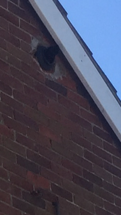

very general starement. in my opinion plumbers are the most complacent of the trades and more than willing to bodge it ,cover up and take the money. and a 40mm waste isn’t always too big for a joist. depends on the joist.
never have to go far to see a plumbing bodge. and this bloke is gas safe.

There will always be bad professionals in any line of work. Oh and BTW it's not plumbing work fitting and positioning a boiler and it's flue, a person doesn't need to be a trained plumber to be Gas Safe registered.
i’m a plasteter . qualified.
and a plumber, gas safe fitted the boiler/flue.....
