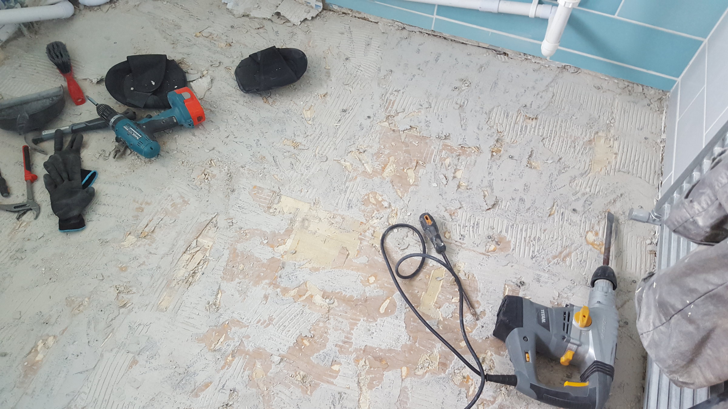

Bathroom floor tiles,underfloor heating need help
7 Dec 2015
5
Hello everyone
Currently removed floor tiles,unfortunately cement board was glued with tile adhesive and screwed to plywood.Braked and removed 90% backerboard using sds hammer,some of plywood got random damage.Can someone give me advice can I lay new cement board over damaged plywood or better idea is to replace plywood(screwed to sub floor)?Thanks in advance
full
I'm sure other folk may have another opinion, but I personally wouldn't mess about any further with that. I'd remove the ply and replace it before carrying on. That way, everything will remain as level as possible. I am a perfectionist though, one of my many traits!
