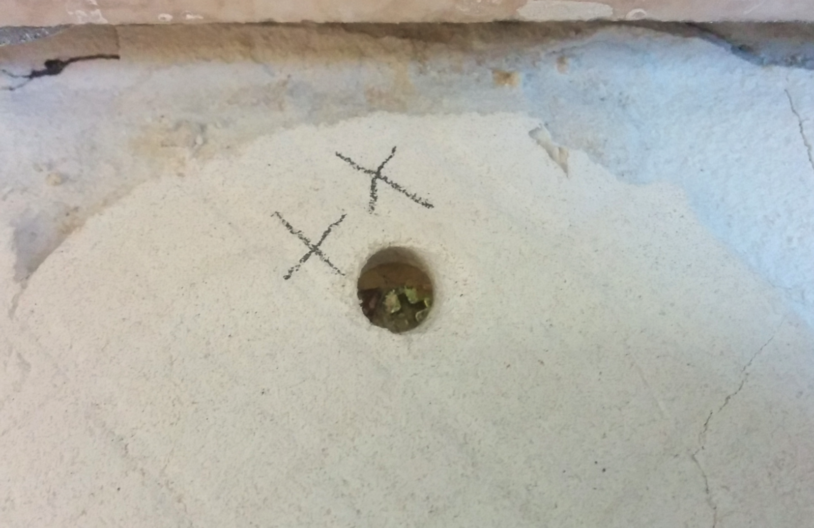

oh right I had this exact prob with a thick 10mm of adhesive, and it was 25mm plywood straight on the joists. In the end I used a metal detector app on my phone (no kidding) and traced out the position of each screw, then used a masonry drill and then scraped out the screw head and unscrewed. a long time later and I had the whole thing up, weighed a ton!
here is a photo of what I meant, the Xs were just to triangulate the position and then I drilled down. About 100 times...
Not sure whether your glue is a bigger problem on top of the tile adhesive though. Hope it helps, good luck!

Did you spot my two posts above yours? I had the exact problem and removing all the adhesive was too messy hence why i thought my solution might help you. Angle grinder indoors turned out not to be a great idea for bulk adhesive removal!
