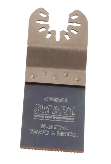

Is there a particular multisaw blade that is suited for this task?
others may have wider experience, but with a multicutter, I found the "finger" blades more suited to an up-and-down cut (and more likely to go through pipes underneath) and the half-round blade is better for a long, straight cut where you can control the depth of cut better.
A circular saw, set to 18mm, is best for a long cut, but won't reach the ends and internal corners. The multicutter will do those.
You can do it with a backsaw, but it's hard work.
Thanks guys. I have one of these on my Makita multi saw and when I tested it recently, it was hard work! Admittedly, the blade isn't the sharpest, so I will replace that.
I know there are other types of blades (different shapes) and wanted advice on that please.
I do also own a Makita Circular saw but as I am cutting up to the bath panels, I couldn't see how this could be used.
On a related note, I also have a Recip saw but don't see a use for that in this project.
this shape. When it starts to go blunt you rotate the tool a bit to use a fresh section. It has a shallower cut than the "finger" blades.
(I have no knowledge of this particular supplier)
