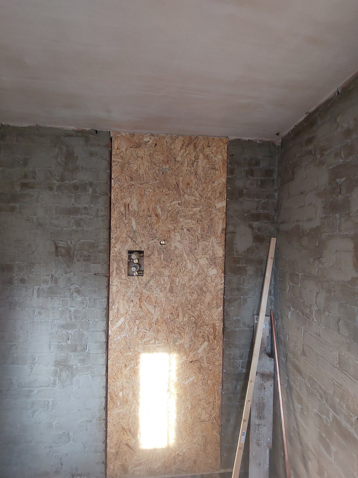

I have blocked up a doorway and have osb board on the bathroom side. I am going to dot and dab tile backer board to the walls and was wondering if I could use blue grit on the osb board as its a smooth surface to give it a key for the tile adhesive?

Thanks for the reply. I've bought that wet room board made out of foam they are 2400 by 600. I've taken the wall right back to brick painted a bonding slurry all over it and the instructions state for me to dab and dob to a uneven wall and then mechanically fix also. There's no lights in there at the moment so will upload photo tomorrow. The only part of the wall which doesn't have a nice key for adhesive is where I've blocked up the old door. I shall try and find a photo now

yes you can. but it would be safer to board over it first,
or you can tile straight on to it with the right adhesive. s2

I waited to see what kind of boards you intended to use before advising you eg. as I suspected there's no need for blue grit. Your pics will provide more information.
20mm Q board is good stuff for your bathroom. You tile directly on to the boards no prep needed.
Thing is, on each wall the finished surface plane of the boards must be flat and plumb, and form accurate 90* corners.

Thanks guys for the help so far. When the dob and dab is dry was going to drill and screw the boards using the washers from the board manufacturers. I shall try some pics again now.
I've painted a bonding slurry all over the wall ready but the osb is very smooth I was hoping I could paint blue grit on the osb for a nice rough key for the adhesive for dob and dab?
personally i’d use bostik green grit as it’s suitable indoor and outdoor. or you could again use blobs of s2 tile adhesive to bond the board to the wall and put a few screws in.
why osb?
and whats the grey stuff you painted on and why? I know you call it bonding slurry, is this tanking?

He instructed me to use osb board as extra structural stability. Maybe he was concerned if my stud work wouldn't be up to scratch lol.
He also said when he boards a room with plasterboard they chuck a mix of cement and sbr all over the walls for a nice surface for the adhesive. To be honest the pointing was terrible so it did the wall a favour. Not sure if this is correct? I will look out for green grit thanks.
