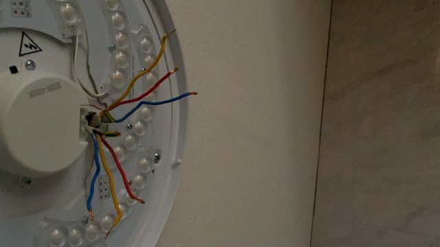

Hi purchased a new led bathroom light and stupidly forgot to take a pic before taking down the old light! There are two main wires. Both have a blue, yellow, red and earth wire. I think the two reds were connected in a single block, both blues in another with a blue wire coming out. Both yellows with a brown coming out. The brown and blue then into light bulb. I have tried to copy this and nothing seems to work!?
Sounds like that would be right but it doesn't work, so...
Have you terminated all the wires correctly, not screwed down on the insulation?
Sometimes the copper will snap just inside the insulation, will feel floppy instead of rigid.

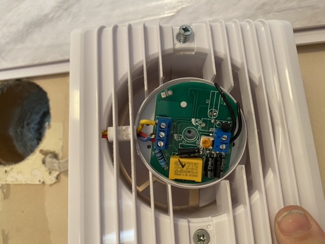

I will try. Looking at the extractor fan. It has red i to live, blue into neutral and yellow into T?
Ok. I have wired the old light bulb into the brown and blue wire but still trips the fuse? I am sure I have copied how I took it out. Could the red of had the brown cable coming out of it instead of the yellow? What does the T mean? Would be so much easier if could post pictures on here

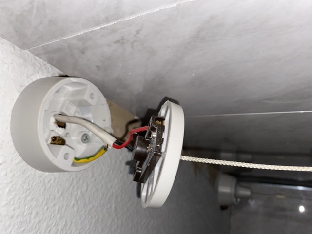

The pull cord switch for the light only has a black and a red and earth! If only everything was that easy :(

T means Timer.
With only a Red and Black at the switch means you must have a junction box somewhere.

This is the light switch pull cord

Yes, just as you described.
You need to find where the switch cable goes.
The fan connections don't look brilliant. Could the blue and red be touching?
