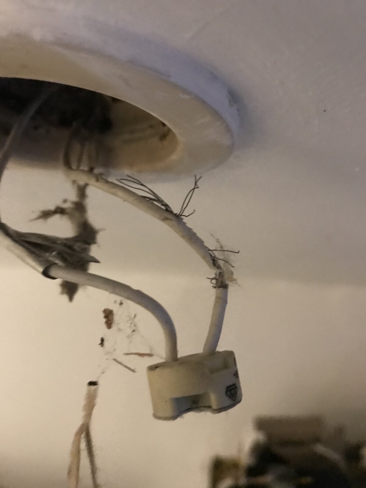

My bathroom has 4 down lights. One is above the shower and I think it’s IP65 and 4 are away from the shower.
The pull cord light switch has a single cable for the switch wiring. Each light then has one of these inside the ceiling void.
The light above the shower works and one of the three lights outside the shower also works.
The remaining two are problematic.
One of these has no power when tested with a 2 pole tester and contactless tester.
The other light activated the “AC” light on my two pole tester. Presumably because they are low voltage lights? But the bulb doesn’t light up in this down light. I used the bulb from the light that works - no joy.
I have also noticed that the wires are damaged. Rodent damage perhaps?
But don’t understand why the bulb does light up if power is being detected.
Also how do I resolve this as I am guessing there is a junction box burried somewhere?
Thanks in advance
There will be transformers, probably one above each light, which will have conked out.
The lampholders can also fail over time too.
You can see the damage to the insulation on one conductor but what if there is "rodent" damage to other (TPS) cables that you cannot see?
Perhaps you should also find out how rodents (or whatever) are accessing your between ceiling and floor space, prevent further ingress - and lay baits for any which may be there now?
Perhaps I should locate the transformers and then the T&E connected to this. If this has power, I should connect new bathroom led downlights to this T&E? Presumably the transformers are near the holes for each down light as in my experience the low voltage cables aren’t very long or far away from the transformer itself. Is that always he case?

UPDATE: The small cables popping through the holes in the ceiling had a transformer connected to it and this was then wired into a junction box which was connected to the lighting T&E on the other end. Each light had two cables and one of them had a single cable. This is the light feed cable looping around the lights I am guessing. I assume there is another lighting junction box up in the ceiling somewhere? I disconnected everything from the junction box onwards. I fitted new mains powered bathroom downlights from Screwfix.
