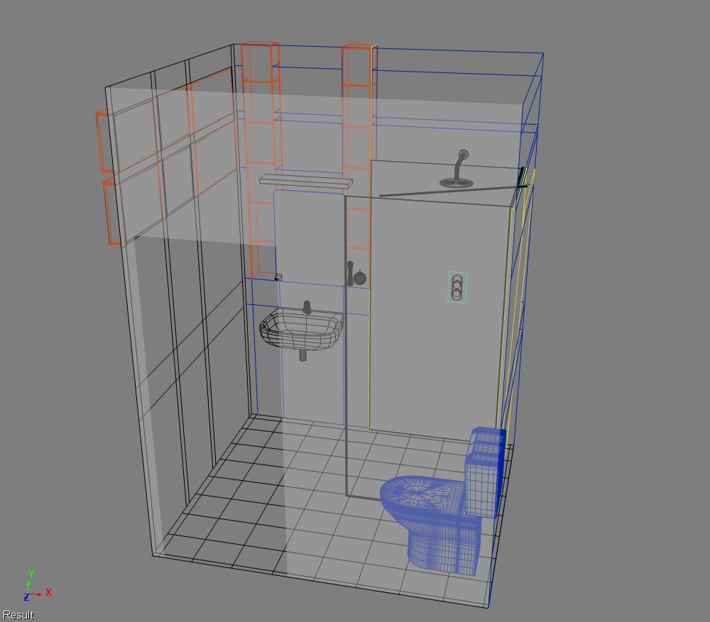

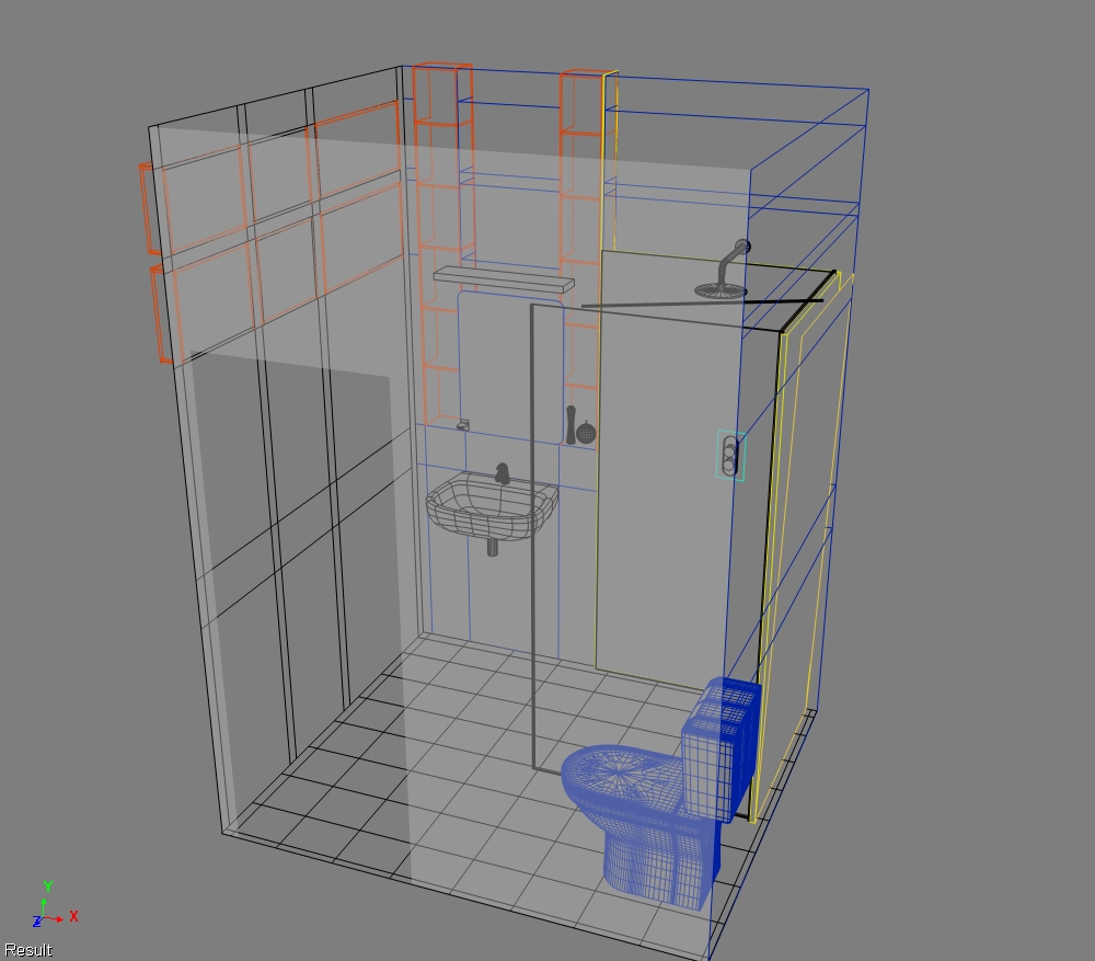

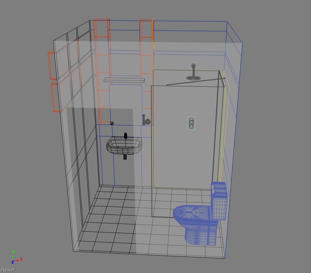

Thanks for your reply. I've attached pictures of the planned bathroom (not a quite a plan). I haven't thought through all the practicalities yet but the main question is if I can manage it is it a good idea to have the ply floor as one piece?

the 2x1.7m part is the problem as said above. 2.4x1.2 sheets are the norm. I believe you can get 10ftx5ft sheets but are more expensive
Thanks domdee. I think I complicated this by giving the exact dimensions of my floor. For the sake of argument say my floor is the exact dimensions of one sheet of ply. Is it better to lay it as one piece, if I can, or is there an advantage in laying it in multiple pieces? Four pieces for example? I'm thinking for reasons of thermal expansion (with a small 1-2mm gap between boards) in the same way bridges have expansion gaps.
Manageable sized sheets would be my preferred choice. Depends which way your joists run as to how many. Like above, pipes will be easier to route. And the backer board sheets aren’t that big so will be loads of joins in them anyway. Just screw the ply down good and proper and forget about it. Same with the backer board. Use screws that wont rust too
This is correct, sorry I missed the measurements.
You will need 2 pieces, so easy piecy.
