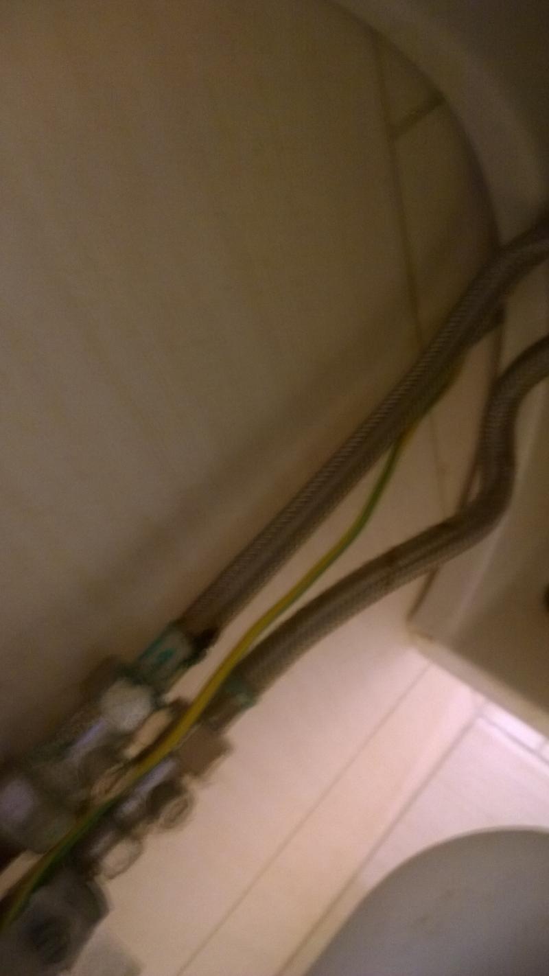

Hi All,
I've had my new place for a few months, and I'm trying to add storage everywhere.

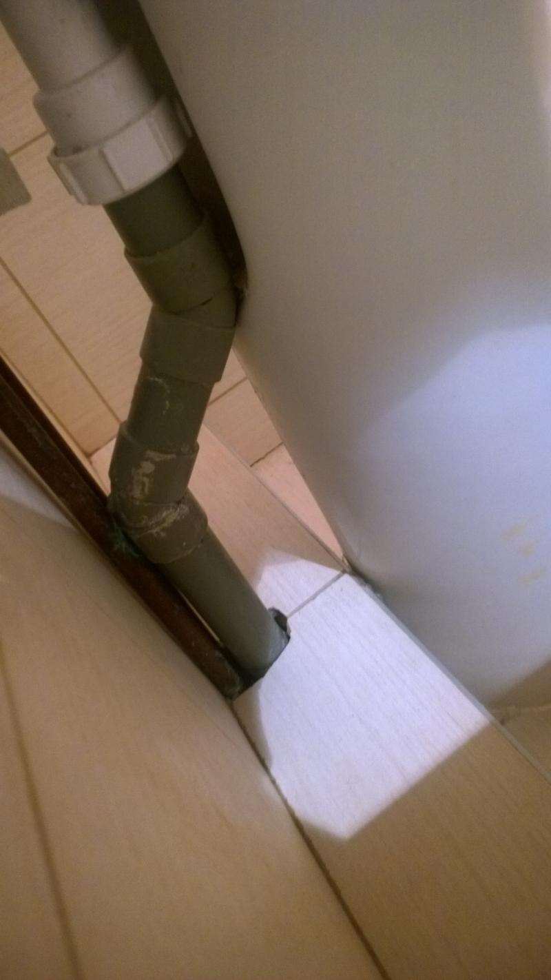

I am thinking about buying this cabinet to replace the sink, as I hear the Ikea Godmorgon range is pretty high quality. Do you think this is a good idea or asking for trouble. The tiles behind seem complete, but it is impossible to tell if the ones on the floor are complete. What do you think?
To further complicate things, I was also thinking of replacing the mirror with this mirror cabinet. Luckily its a few CM bigger in each direction, but is this going to be trouble? The current mirror is 18 cm above the sink, so I'd need to get a fairly short tap.
Thoughts positive or negative are appreciated.
Your project should be completely feasible, but sometimes IKEA stuff isn't so obliging when it comes to accessing the drain pipe etc.....the existing is solvent weld stuff.

Thanks for your quick replies
Sometimes IKEA stuff isn't so obliging when it comes to accessing the drain pipe etc.....the existing is solvent weld stuff.
Can you recommend any brands in particular? I don't mind that much, I just want something that will still be ok in 5-10 years.

No reason at all why you can't have your Ikea unit, just try to get a look around an assembled one in the store if you can - just to see how the access is once it's in place.
