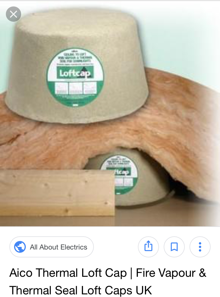

hi, looked through the Wiki but still need some help please, we have removed our bath and in its place we are having a shower enclosure fitted, the room is 2.25mtrs high and has existing spots fitted above where the shower will go, what do I need to do with these to comply please?
Nothing.

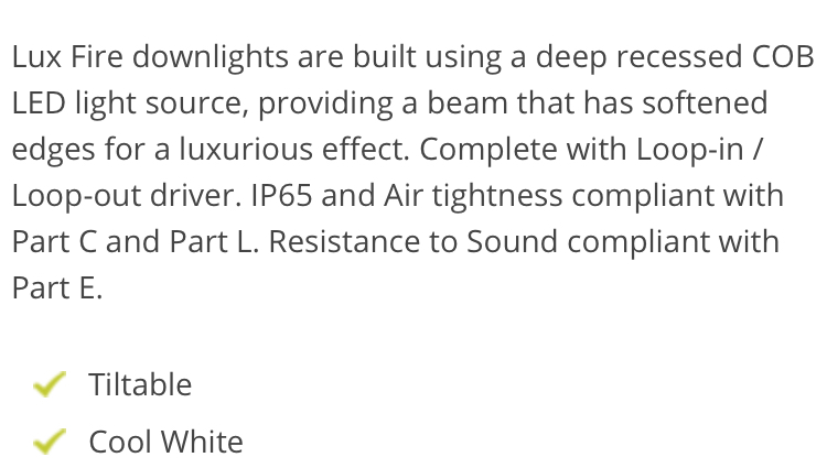

Although, I would want them to be Part C compliant (to prevent the passage of moisture through the downlight into the space above.
Thanks, how is that done please? There is already an extractor fan above the where the shower will go
You can check the spec for the lights to see if they comply.
Look for something like this
Or you can fit “loft caps” to the downlights.
