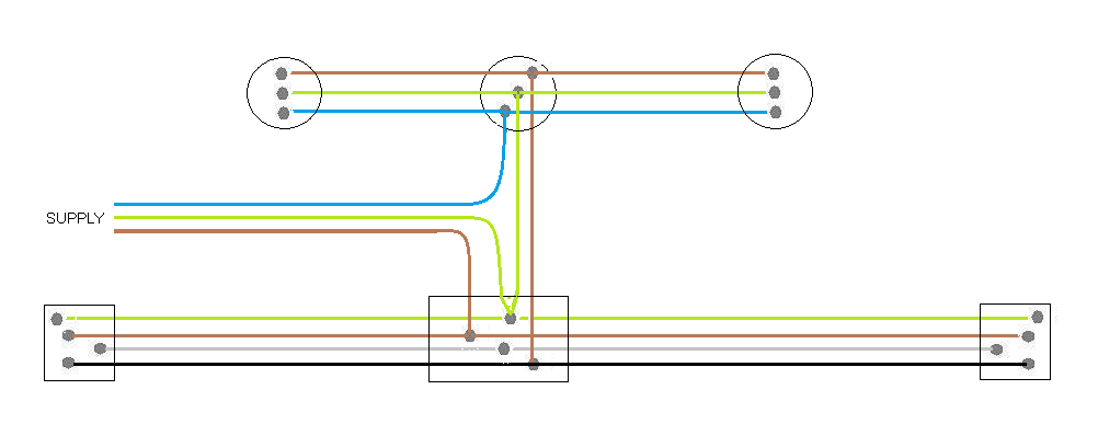

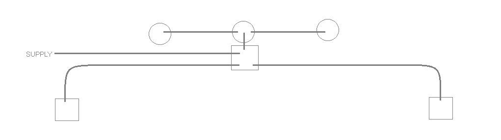

I have a 6 metre conduit 1 light at each end with 1 in the middle.
Ok.
The supply and 1 switch enters from the right and the other switch enters from the left currently meeting at a 4 way conduit box. Its evident I will have to introduce a 17th edition box or similar?
We're on the 18th now. Any junction box with cable restraints will do.
I am not sure what you are asking if it's all there already.
Really appreciate your indulgence and thanks for sticking with me. I am thinking I might get a local sparky to complete this for me? Reading back I guess I wasn't really clear? So you understand where l am everything is installed with the exception of the cabling.
This then is what you will need in terms of cables.
You will need 4 core for the cable from switch to switch.
Do you want to know how to wire it?
You might need another connection in the junction box for the blue wires if the JB is any distance from the light.
An ordinary connector block would do if there are not enough terminals.
