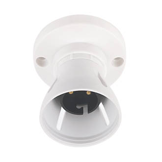

What difference if any is there between batten holders and those described as loop-in? Thanks Marcus.
Battenholders are battenholders, but some have a modern 'loop-in' system consisting of terminals with many holes to accommodate loop in wiring, whilst the older and cheaper ones don't always have this - infact they don't even come with any form of backplate.
Battenholders without the loop-in facility do have a spare terminal, which can be used for the earths or the permanent lives, but they are fiddly to fit. A back plate pattress is available separately, and these often have a terminal design for earths, not lives.
All in all, the modern loop-in battenholder is by far more superior.
Thank you, I am extremely grateful for your comprehensive reply. The local trade counter was unable to provide an answer when asked! I would like to mount on to a conduit box however I do need to find something with holes that align?
A batten holder fits neater on a conduit box, but screw heads are visible, any extra wires can be terminated inside the conduit box using connecters, a loop in one hangs over the sides as its bigger

Now that's interesting so the batten holder would screw into the box? Would it, therefore, be easier to use the loop-in type to connect holders together?
View attachment 171819 This one is listed as loop-in at screwfix?
It is technically also a loop in.
As someone mentioned earlier there is an extra one terminal to use as loop in, but its fiddly when you try to put 2 browns into it.
Whereas the bigger one has a base similar to a ceiling rose so more room and easier to use as a Loop in.
Both types will have holes in it spaced to fit your besa box
