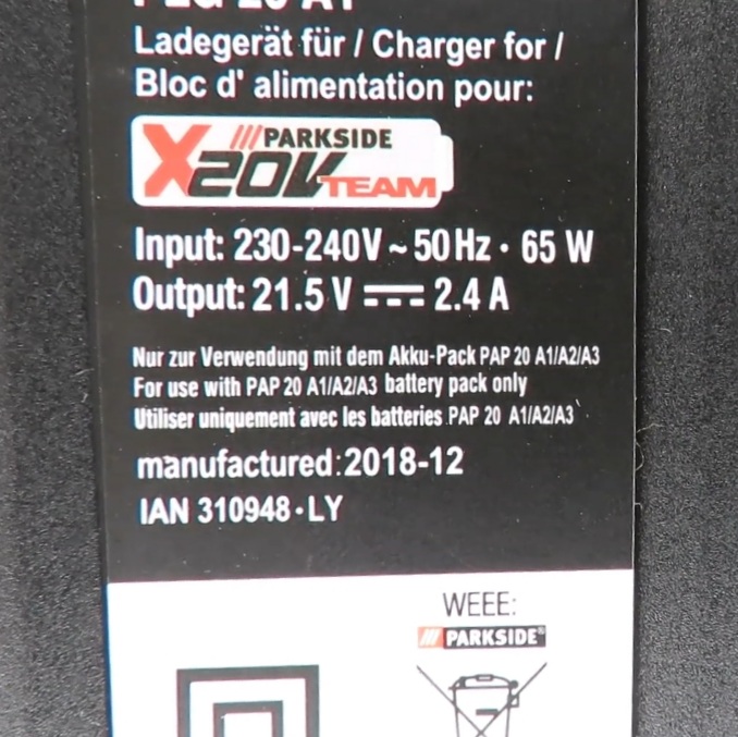

R RandomGrinch Joined 15 Jun 2021 Messages 7,419 Reaction score 3,037 Location Wales Country 6 Jan 2022 #2 Yes you can! Ps it should say on the back of the charger which batteries it is compatible with ......and it will take a bit longer to charge!
EFLImpudence Joined 7 Jul 2010 Messages 44,584 Reaction score 6,500 Location Retired to: Country 6 Jan 2022 #3 richard j baker said: could anyone tell me if i can charge a parkside 4ah battery, on a parkside 2ah charger, both being in the 20v team series. Click to expand... Just to point out that your charger will not be 2Ah; it will just be 2A (like the one pictured is 2.4A). That is capable of supplying 2A for as long as it is charging. Your battery at 4Ah can (theoretically) supply 4A for an hour or 2A for 2 hours etc.
