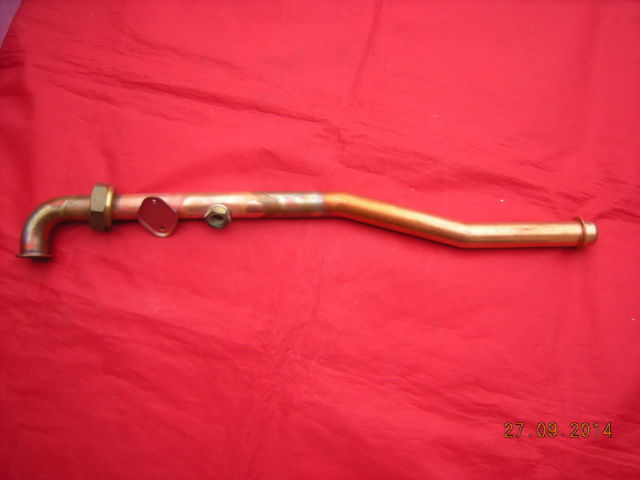

Solved!!!
Baxi engineer fixed the boiler last night, 22mm pipe from heat exchanger outlet to diverter valve inlet was partially blocked with black crud - new one fitted and hey presto everything working as it should!
He said he could hear a small amount of "Kettling" which led him to suspect blockage and restricted flow.
