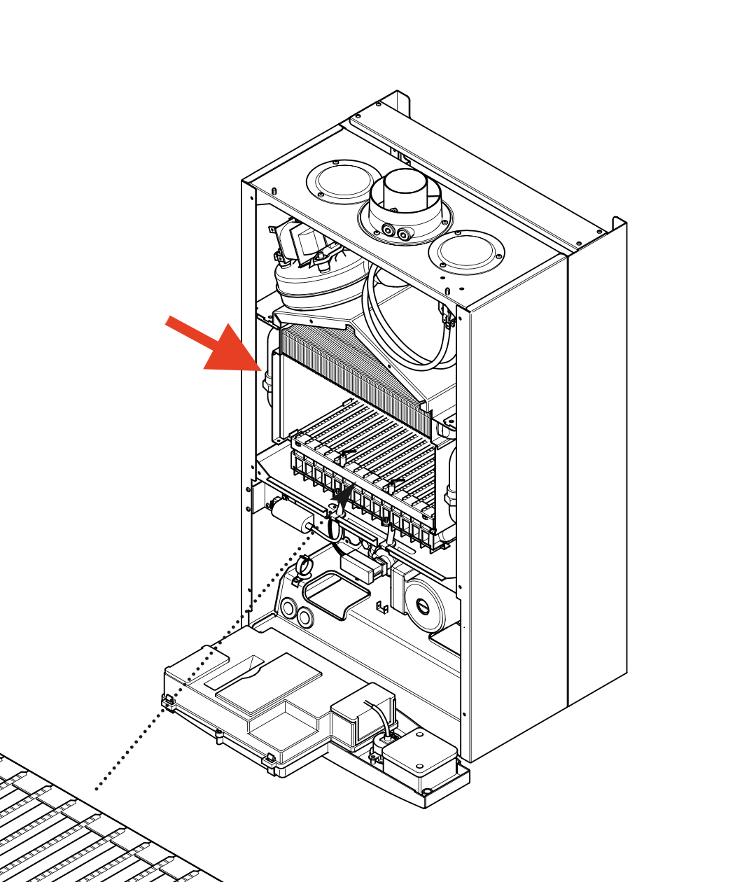

One thing I did notice was a drip/leak from the pipe that runs along the left hand side of the boiler (see red arrow in diagram below) - I'm guessing the O ring or seal has gone (and I am guessing because I must have over-pressurised the vessel because when these issues started there was a leak from the front of the chamber and I am guessing it was this pipe) Here's where that pipe is (red arrow):
Any thoughts? Should I go ahead and replace the vessel, diverter valve and motor? (I've watched the YouTube vids so think I am can do so competently) or do you think I should just get a new boiler?
Looks like a compression fitting, so maybe attempt to tighten first? Could be a fibre washer, but @gas112 will know better than me. I would maybe try and dry the motor, depending how bad it’s been leaking, and replace the diverter cartridge.

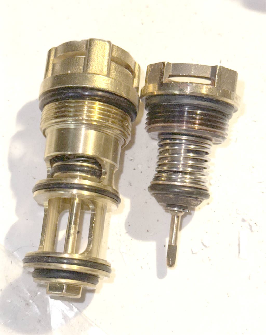

Thanks @CBW - I went to fit the diverter valve but discovered the one I bought (the one they advertised for the 105e) is too big!
Here's the one they sent (left) vs the one that's in my boiler (right):
That's before I cleaned it mind - it was black and basically closed shut. So I cleaned it, greased it, then put it back in and now.... I have heating!!!!! :giggle:

1) Does it look ok now that I cleaned it or should I purchase a new one? (The only one I can find that looks anything like it is this repair kit off Amazon: https://www.amazon.co.uk/HTS-Compatible-Duo-tec-Instant-Diverter/dp/B09GMCP75K - does that look ok or is there a better replacement around?) I will check the diverter valve tomorrow for any leaks (there was water pooling at the top when I went to remove it).
2) Do you think that my expansion vessel might be ok after all? For instance is there a possibility that if the diverter valve was stuck in an awkward position it might have been that that had been preventing the expansion vessel from getting a charge? (I didn't fully empty/recharge the vessel as I didn't want to jinx anything, not that I finally got heating back on!)
