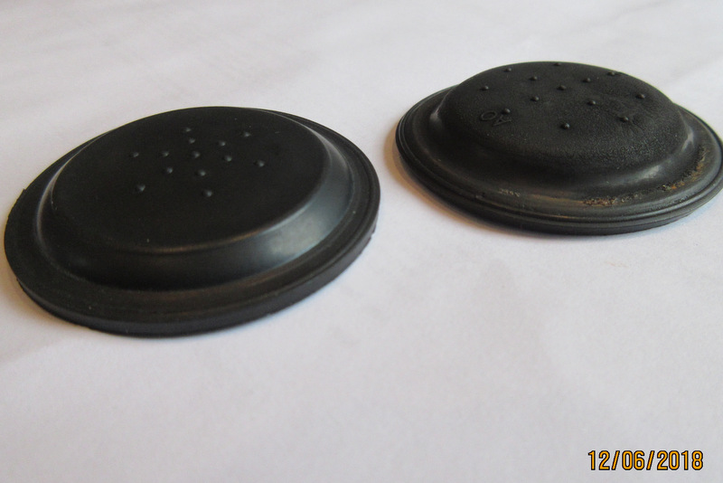

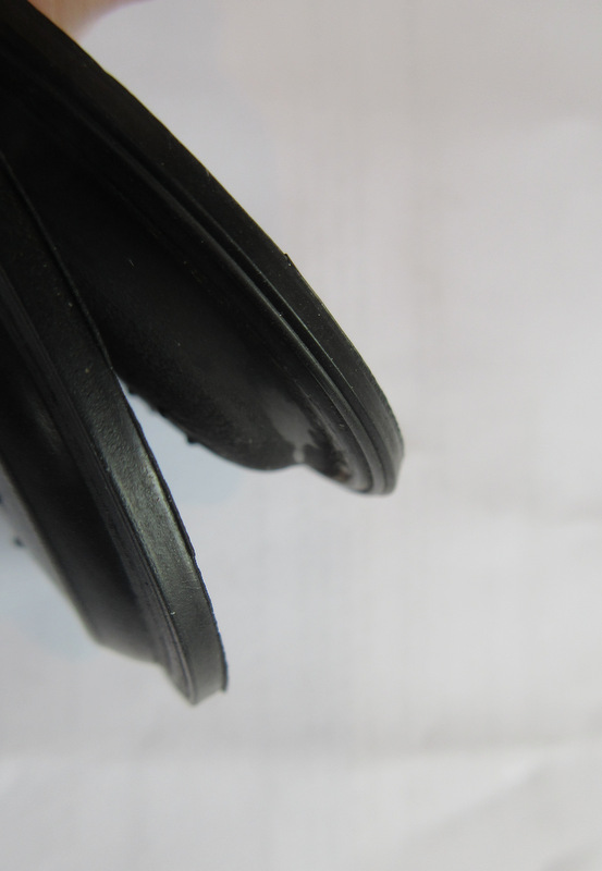

I have it working A1 right now (fingers crossed) and the final fix seems stupidly simple. It has taught me about the gamble of using kits of parts made god-knows-where by god-knows-who. I've bought a lot of parts via ebay etc and had to return quite a few for poor quality or ask for missing bits to be sent. With this renovation i had to have a full kit of all the bits for the diverter valve. I have dismantled it a couple of times so i'm really familiar with it, so i was confident about it when i re-fitted it re-built. But as my post says, it did not work A1 although it would fire up after 2 or 3 attempts. Anyway, i re-opened the CH diaphragm chamber as that's where the pin was lifting by about 75% of what it should do. Could not see anything dramatically wrong but when i got the new diaphragm out and compared it to the old one, it felt a lot thicker and stiffer. I've tried to show in a couple of pics, but it's the way it feels that really matters - i put another new (but thinner) diaphragm in, and the boiler immediately fired up first time with the pin showing full travel up to the microswitch. I've tested it 3 days in a row and both CH and hot water are great.
No wonder pros refuse to re-build diverters and insist on a proper Baxi replacement !
In the pics the problem diaphragm is the thicker one (on the left) with the obvious ridge all around - when pressed in the middle it has very little 'give' so it was restricting the upward movement of the pin towards the microswitch. That's my theory anyway !
