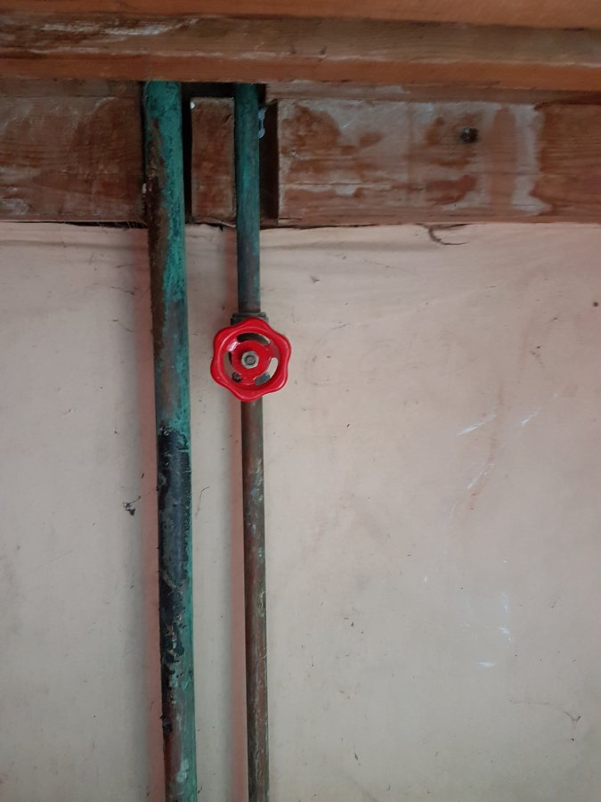

So I went into cupboard where cylinder and header tanks are. When I got up there, I realised one of the taps were turned to off, so I turned it back on. (I note, that this tap was from the smaller, higher up tank)
After a few minutes, behind the back boiler downstairs, there was a leak. So I turned it back off upstairs and didn't switch on the boiler for heating for about 2 weeks.

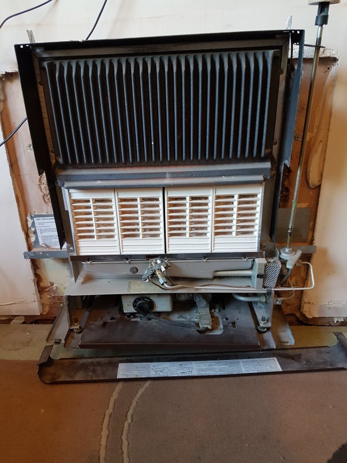

What exactly is it leaking? A photo will help. Did the engineer inspect the heat exchanger for any water stain?
Daniel.
Not sure what is leaking exactly, it drips from behind the fireplace downstairs.
The engineer did mention that there was a leak at some point due to some calcification around one of the pipes. We knew of an old leak and presumed it was that.
Though, I haven't called out the engineer since the leak happened last time.
Without taking the whole front thing off, I couldn't tell you. (Am I allowed to remove the front?)

Attatched are pics of fireplace/back boiler. And the tap thing that's switched off. (one that leaks when turned on.) connected to smaller header tank.
Not sure if any if these are of any use at the moment. Pending whether I can take the front off, would depend on more pics :)

No you cannot remove the front and need a registered RGI to remove the fire, you've already taken the case off the fire.
All your doing by opening that gate valve is allowing the system to fill and essentially the water your adding is then leaving through the leak on the boiler.
Get someone qualified to remove the fire front and check where the leak is. Gaskets are shown as available for heat exchanger, and any other leaks can be repaired. If it's a 552 model then if repaired and serviced it will last many more years.

The gaskets are cheap, it's the labour involved to do the repair. I've done them in 4 hrs. It's worth checking out. A guaranteed repair will be vastly cheaper than a new boiler.
