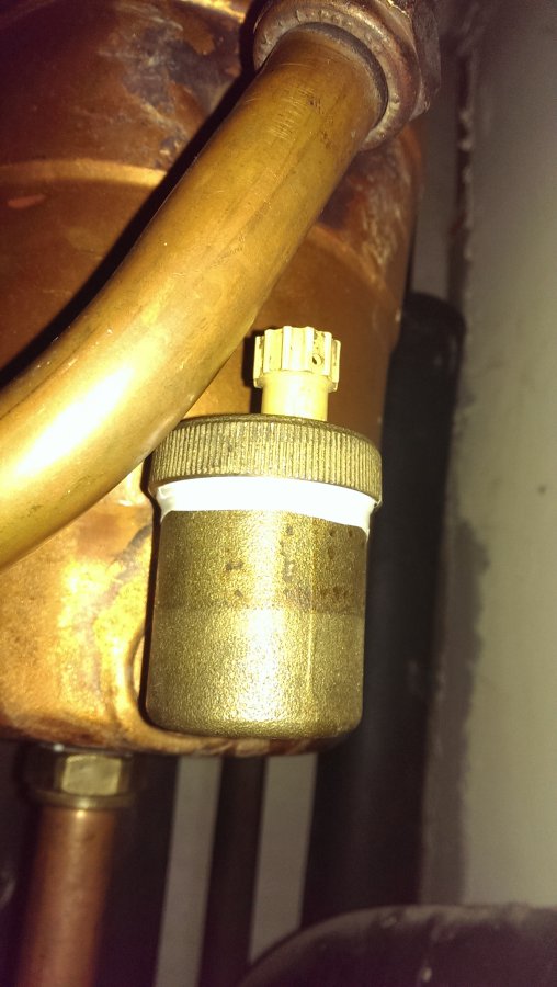

I have now removed the section of pipe which I knew was blocked for sure (not going to provide a photo but it was really bad), I also noticed a defective automatic air vent connected to the Spartan ET50, it is constantly closed. I manually removed the air from the vent by unscrewing the top cap, this caused the water to fill-in the system, the boiler has now been up for 30 min (had to remove the air from the pump too).
I am not keen to replace the whole air vent, it is connected to a very old expansion tank (i.e Spartan ET50) which I am afraid to damage. Instead I would just like to replace the inner system and top cap, hence I would need to purchase exactly the same AAV. The only think I can say about this AAV is that it is 4cm wide and 5cm hide (no label for pressure...).
AAV with side entry:
Would you know the best place which sells AAV and where I can get the full spec (i.e. dimensions) before purchasing?

I doubt that angled ones like that are still available.
Current top parts MIGHT fit but if I was faced with that I would extend it outwards with pipework and fit a normal in line new one.
Tony
