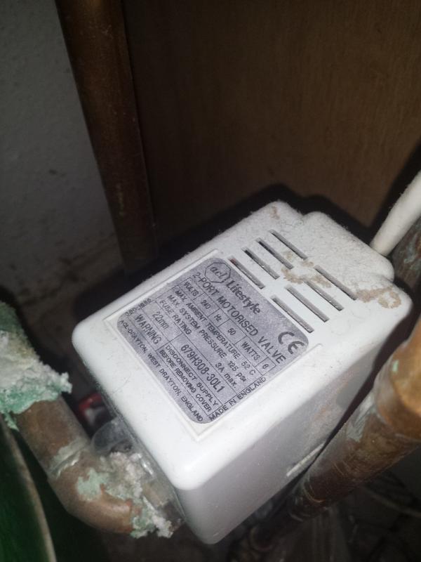

I've taken a look in the immersion cupboard and uploaded a photo of the motorised valve, zone valve actuator and a bit of kit above them . The motorised vale and actuator both have a black lever which is currently extended and to the right (meaning I can put it in, and left, and manually get water moving through it). Needless to say I've no idea what I'm doing when holding it one way or the other, just hoping one of you folks can glean a bit of info from that.

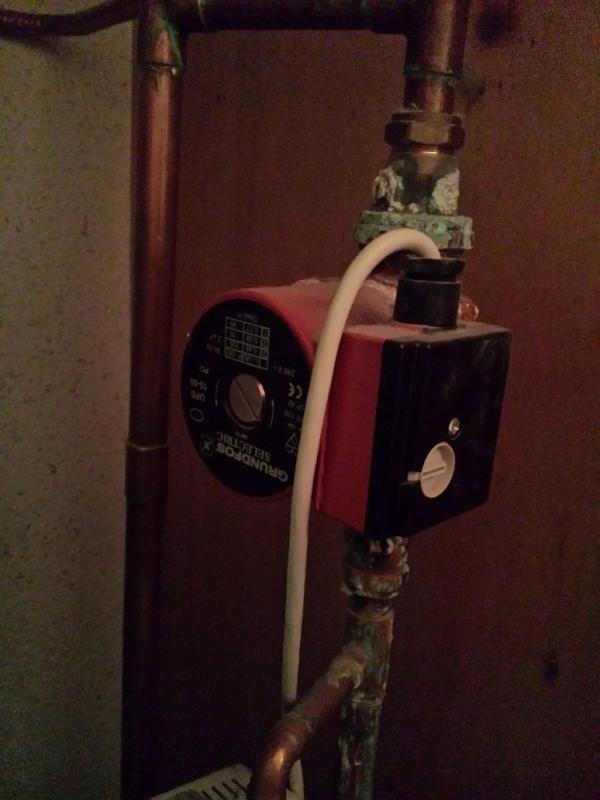

CHeck the pump isn't sticking. With CH on, if you switch the speed changer between 1,2,3 you should hear the difference.
In the first pic there's a black indicator on the LHS of the valve head. it should move end to end when you switch between ch only and hw only.
These valves tend to stick. The Manual lever poking out of the top will allow you to open the valve from HW only to mid/both CH & HW. The HW will mostly short out the CH though as the cylinder pipe's an easier route for the water to go through, than all the rads.
Cylinder thermostat needs to be Satisfied for the valve to go to CH only.

Tried seing if Pump was sticking, by holding manual level on valve head to the left to force water through and changing the speed settings. Could hear the difference so don't think it's that.
As for the black indicator, it's hard to tell what it's on - if I push it there are no identifiable steps. Just goes in and comes out again.

I agree the valve's stuffed.
SOrry I 'm confusing the valves in the earlier post which is therefore wrong - I thought it was two pictures of the same 3 port - you have 2 x 2 ports which is simpler..
Locate which is the CH valve - ie not the one on the pipe which goes to the HW cylinder.
Now use the longer black lever to latch the CH valve open. You should have to push against a sproing but if it's seized/stiff, it might not spring anywhere.
That might turn the heating on, it depends on the valve. I don't think it will. But while the boiler is on, you will get some heat in the radiators.

Errr that is not a 3 port valve, it is a pair of 2 ports, I suspect the actuator or valve is seized on the Heating valve ;)
ok thanks all, so the general consensus seems to be the valve from the CH is goosed (just to confirm, the black lever works fine on both so nothing is seized)

With the black lever you should be able to shove it open against the spring then hear it clockwork-style zzzzzing close in about a second.
If it's seized it'll be much slower or not go full travel, but you won't be able to tell much.
Ther's a lot of slop in the lever, go by the sound/resistance.
They either seize or the motor dies. Otherwise - loose/ wrong wires somewhere

You should be able to tell if the electric is opening it when it should (it's slow to open, maybe 15 seconds)
yeh if I push it open it whirrs back into the previous setting

Have had a play around with that valve and if I hold the level across in the open position (has to be all the way across mind) it engages and I get some heat into the radiators. Unfortunately seems like it's got to be held in place like that though, as latching it across doesn't hold it open enough to trip the pump.
yes that's what I meant about not knowing whether it would start the boiler or not. Some do, most don't. Therefore you have to go through the rigmarole withe HW stat up, boiler stat down, etc.
Sometimes you can wedge them with a lump of cardboard, but not usually.
