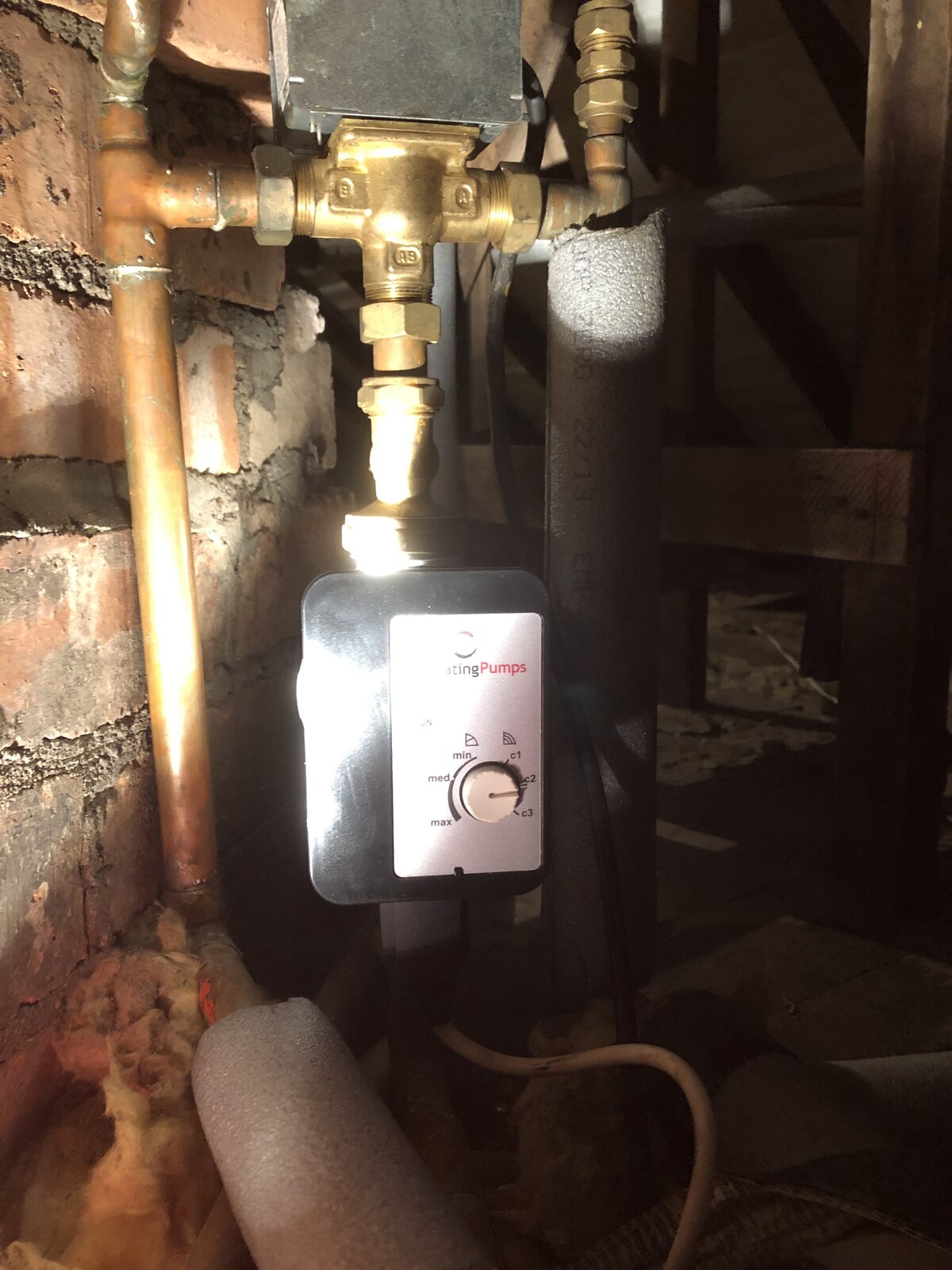

Can't see the "pointy" end on the pump but as long as its not running at full speed which at a 6M head can create havoc on open vented system then should be OK, speed "=" (2) will normally be around 3/3.5M which is fine, where was it pointing originally? That pump is over 18 years old, week1 2007, PC0701, so just the possibility of sticky operation or reduced flowrate due to sludge/scale build up in its ports and impeller, normally, its quite easy to inspect this by isolating the pump, removing 4 set bolts and pulling the pump head out, but if the boiler is running continuously for "hours" on end then unlikely to be the problem.
Re kettling, you say in post #1, "My boiler starts up then shuts down just after starting theres a sound of air rushing....." if its shutting down immediately or shortly after start up then the pump might not be starting or is sticking, causing the boiler to reach its target temperature +5C and shut down, then you can get this kettling sound. Normally, when the boiler shuts down due to a roomstat or cylinder stat reaching its target temp, or is programmed off, then the pump should run on for a few minutes to dissipate the build up of heat in the boiler HEX, if the burner shuts off because the minimum boiler output is greater than the heat demand then the pump should just continue to run, the burner should then cut back in when the boiler flow temperature falls to target temperature - 5C
