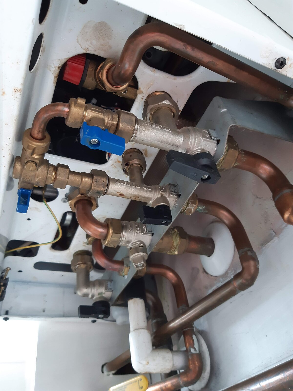

have you mistakenly closed one of the isolation valves underneath the boiler, post a pic of then and we will tell you, it is a common problem when someone tries to top up the pressure on that boiler
I do not think so but here is a pic
They look correct, but those plastic valve levers have a tendancy of splitting and dont actuallt turn the valves, the two outer most valves remove the small srew and pull the lever off and you will see if the valve has actually turned, if the lever has worn just turn the valve with a small adjustable or a pair of grips

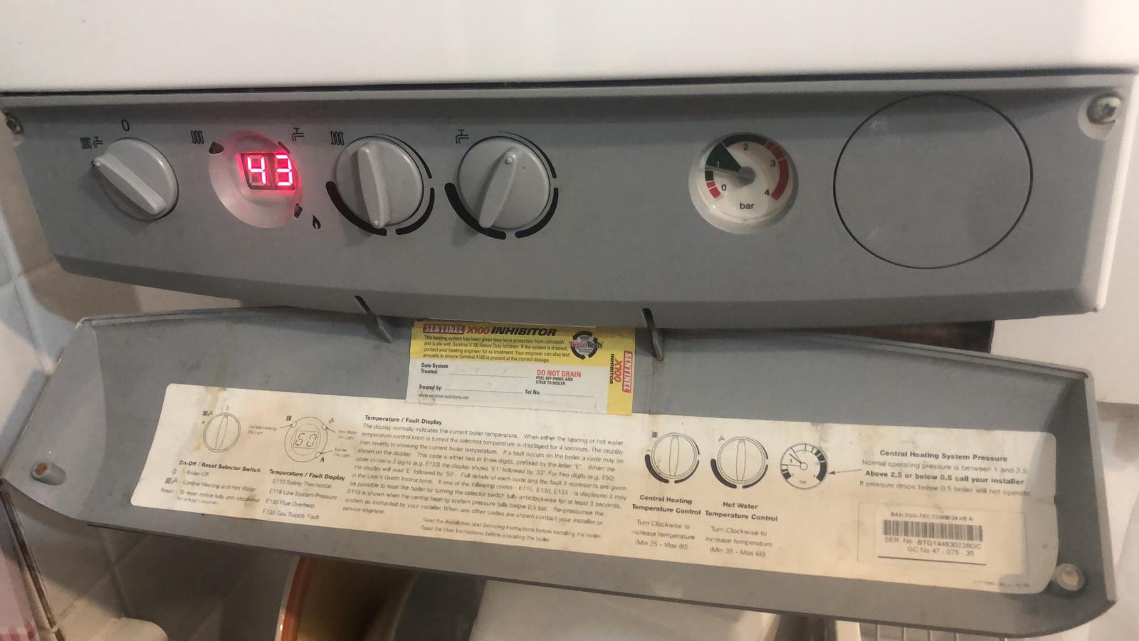

the display show the temperature which is 90 degrees and keep fluctuating between 90 and 88 however, as soon as I open the hot water tap. I get very hot water, (you can not even touch it) for few second

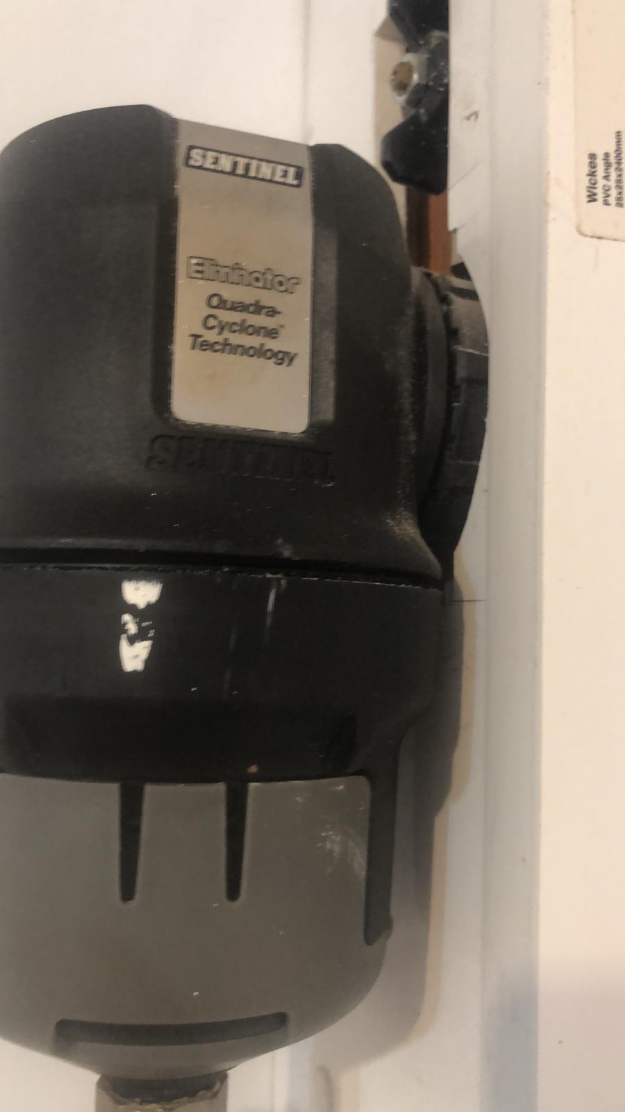

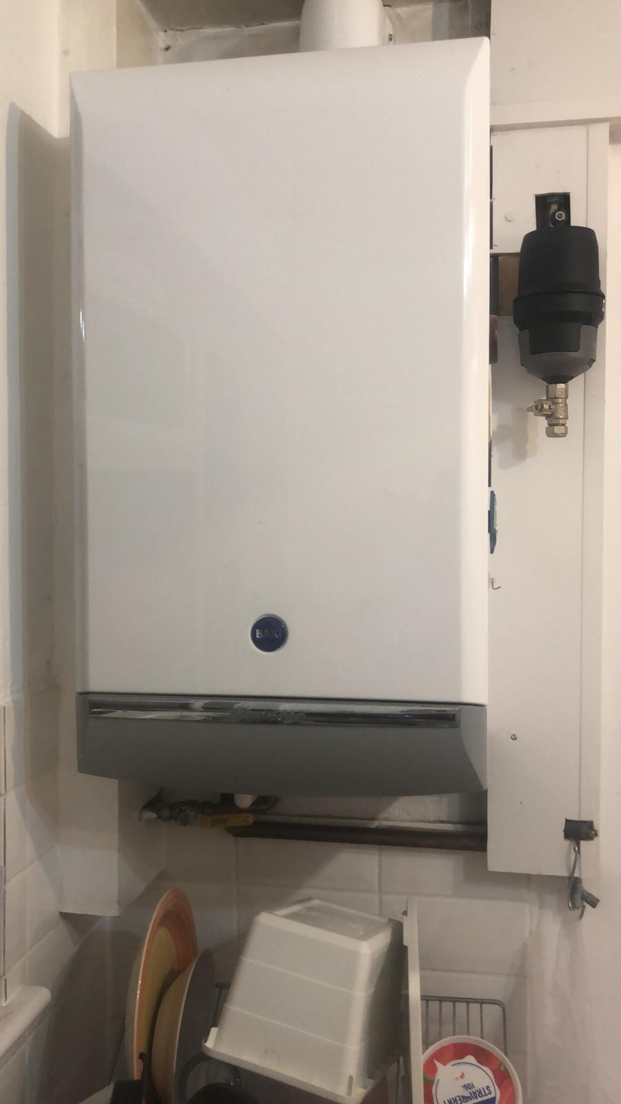

there is filter in the system in the system which I did bleed today. there is a lot of black stuff came out. see pic. this might be block. how do I check whether or not the diverter valve is faulty.
