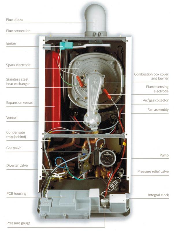

baxi platinum 28he with no rain ingress tray surely not????

By the way, Baxi Solo does not have a drip tray, but does have a lip on the flue terminal to stop water ingress via outer section

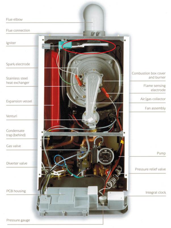

My dads is the first issue of this boiler look how the drip tray only catches the condensing inner part of the flue but not the inlet side of the flue my dads boiler is the first link shown below:
http://advance-heating.com/baxi.html
Now compare this with the revised model of the platinum 28he look how the drip tray has been extended to catch any ingress from the inlet of the flue thus proving that baxi know there is a problem and have amended it

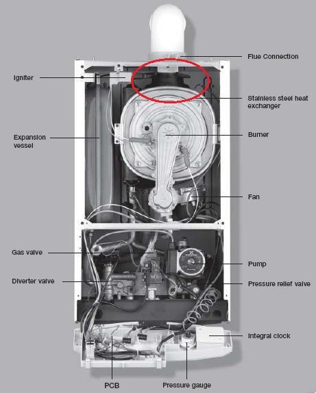

How do I add pictures in my post rather then links ? can anyone help me I seem to keep getting an error when I try
I figured it out lol
here is my dads boiler noticed how the drip tray doesn't catch the inlet side of the flue allowing ingress into the boiler

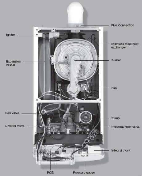

Now here is the updated new version even though baxi said there was no fix
its as clear as day that they have fixed it therefore have admitted they were wrong in their design therefore admitting they wrong +
Have you checked where condense has been connected to ?
yes the condense drip tray is connected to the condense pipe which then terminates outside and is free flowing. I think the picture clearly shows the problem the original drip tray only catches the inner flue and not the outer were the newer model catches both eliminating the problem
Outside into what ? a gulley ? a waste pipe ? an open ? drain
Surprise surprise heat team couldn't provide a fix so i called them and told them I was disgusted with the outcome to my surprise I was offered a full refund. Apparently there is no retro fix for this boiler how disgusting is that a boiler that allows water to run back onto electrical components and baxi can't provide a fix even tho the newer models of this version of boiler has the fix using a extended drip tray
