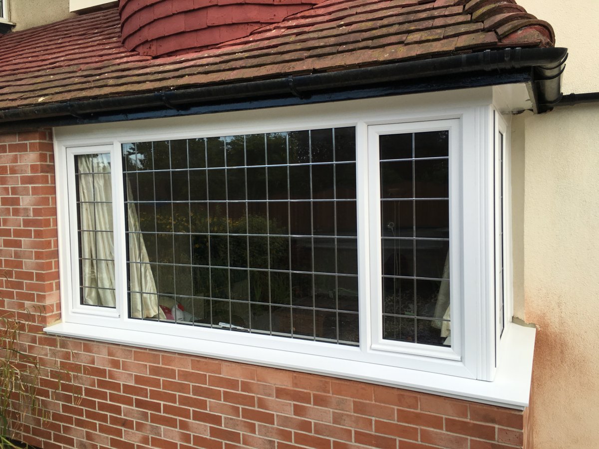

I have just had an L shaped bay window replaced (rotten wood with UPVC) and during the install process I was told about the importance of the corner post because it carries a lot of the weight of the sloped roof structure above.

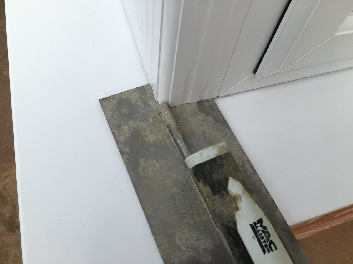

I've noticed today that the post they have used isn't in contact with the sill and floats above it (I can see the bottom of the aluminium tube inside). I had expected this to continue through the sill to the brickwork.
Am I being dense or have they done this wrong?
If it's a load bearing bay then you are correct and what they've done is wrong, they should of used a bay jacking pole which as you say continues through the cill and sits on the brickwork and not the cill, this is then wound up like a small acrow prop, a steel plate is also used above to stop the pole digging into the timber roof structure, post some photos

A picture of the bay above too please but it doesn't look good already, I'd also be concerned about the 25mm plastic trim under the cill, looks to me that the bay is too short and it's not sitting on the bricks, just being packed up with packers and the gap covered with the trim, the same could be said about the trim to the top, what's behind it and what's the roof structure sitting on.......ALARM BELLS!!!

It is sat on bricks - the ones you can see in the picture are slips that are on 9cm of foam.
The actual wall is in line with the top of the windows, hopefully you can see from this old photo.
The lack of the bay pole going through the cill is very alarming. I also wouldn't have thought it should be Aluminium ... all our Load bearing poles are Galvinised Steel ( I hate drilling them lol! ). and as Crank says it should be on the top of the wall , with a Bay Pole Jack. I see Cranks issue with the trim at the bottom , Why use a trim? Normally a bit of sealant is sufficient. I would just double check that the cill is on those bricks, but saying that , it will need to come out to do that Load Bearing post correctly

I tell you what they've done here, they've cut the legs off the old hardwood subframe and left the head in and fitted the new frame under the old frame hence the need to cloak it with trim to hide the hardwood

The cill is sat on bricks at the back under the glass bit (I saw them putting this in). The bit at the front is just to hide the joint to the foam insulation / brick slips.
Not sure what the post is made of now. Just check the spec and the upper bay poles were listed as aluminium reinforced this one is just listed as reinforced corner post. The metal tube looks quite thick.
The thing that has really hacked me off is that after the first day they had installed the upper bay but hadn't put the front trim on the outside on. I reached round and could feel there was nothing but foam above the window (despite them having installed bay poles and bottom jacks). I made it clear that I had noticed this and wasn't happy that they had left the bay like that with no support. Their response was that they had intended to pack out the tops the next day. Apparently this has been done and they have photos to prove but I haven't seen them and now I'm concerned that bay is messed up as well.

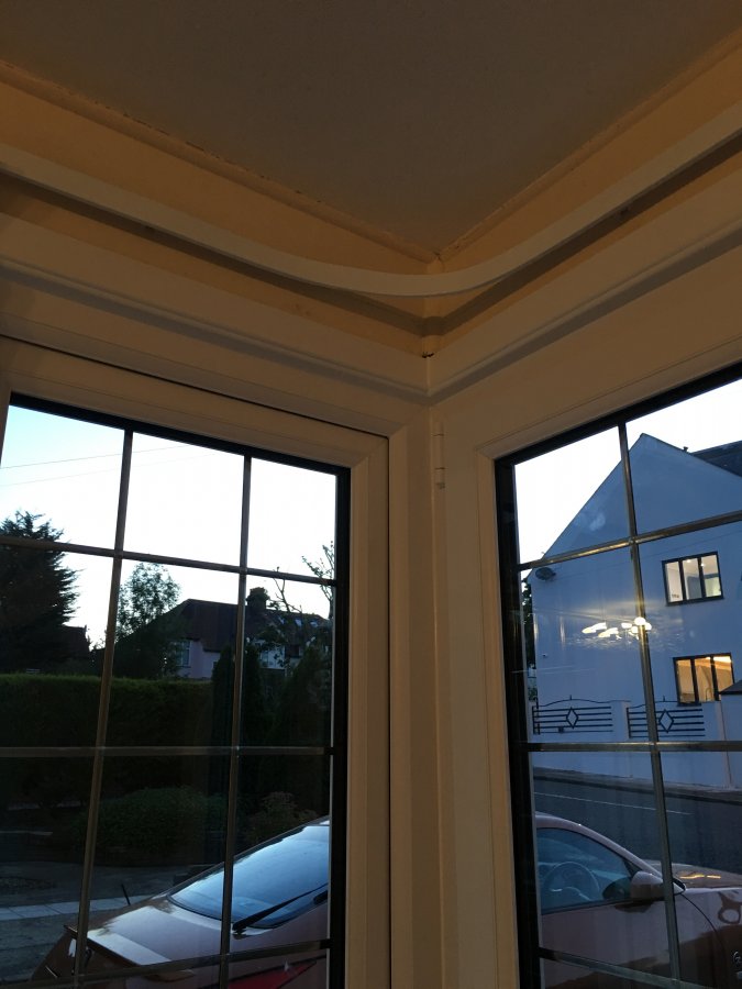

So that's a photo of the upper bay and of the inside corner where that post is. The trim in the corner above the window looks wonky, that's not new - I first noticed it when I decorated almost 2 years ago so that's completely unrelated.
I'd want solid proof that they've fitted jacks upstairs and downstairs, for your own peace of mind I would suggest that you ask them to remove the trims and physically show you the jacks are in place, if they are then you would be willing to pay them half a days labour for their service engineer to refit the trims, if they're not then they want fitting at their expense otherwise you'll involve FENSA or CERTASS if they're with one of them
