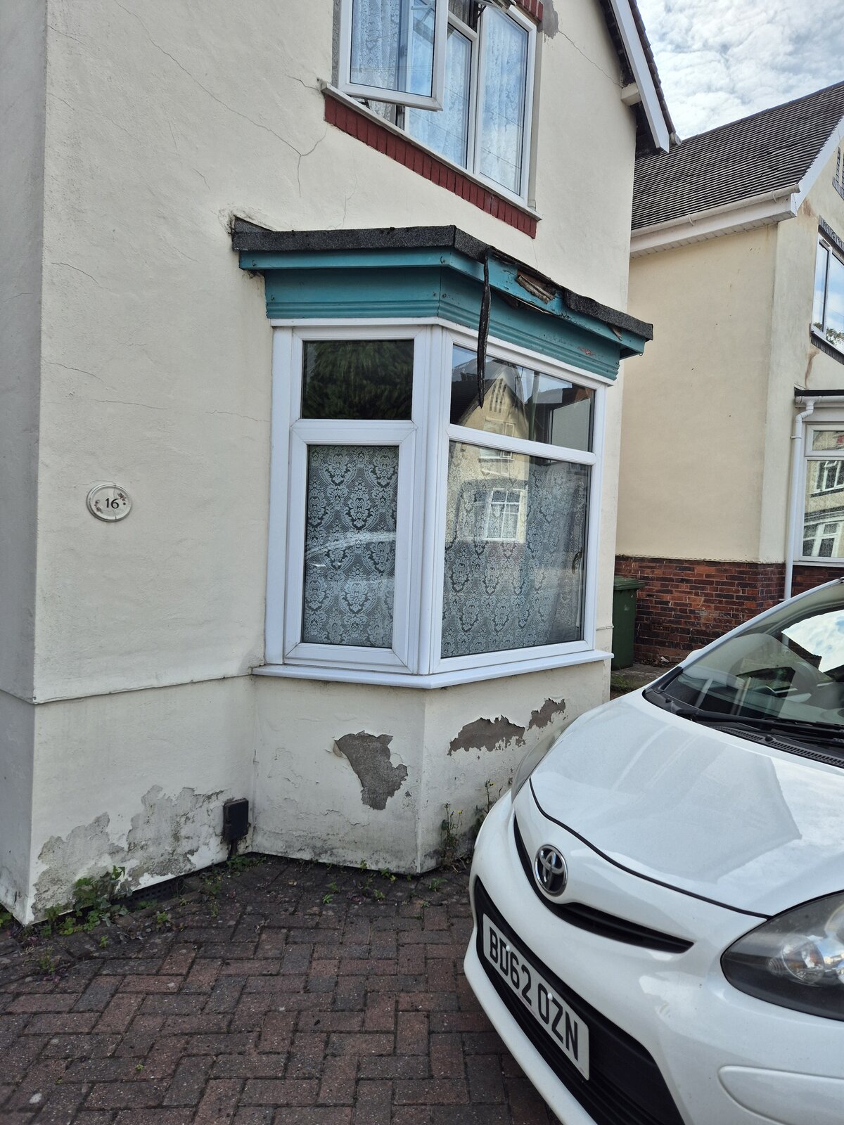

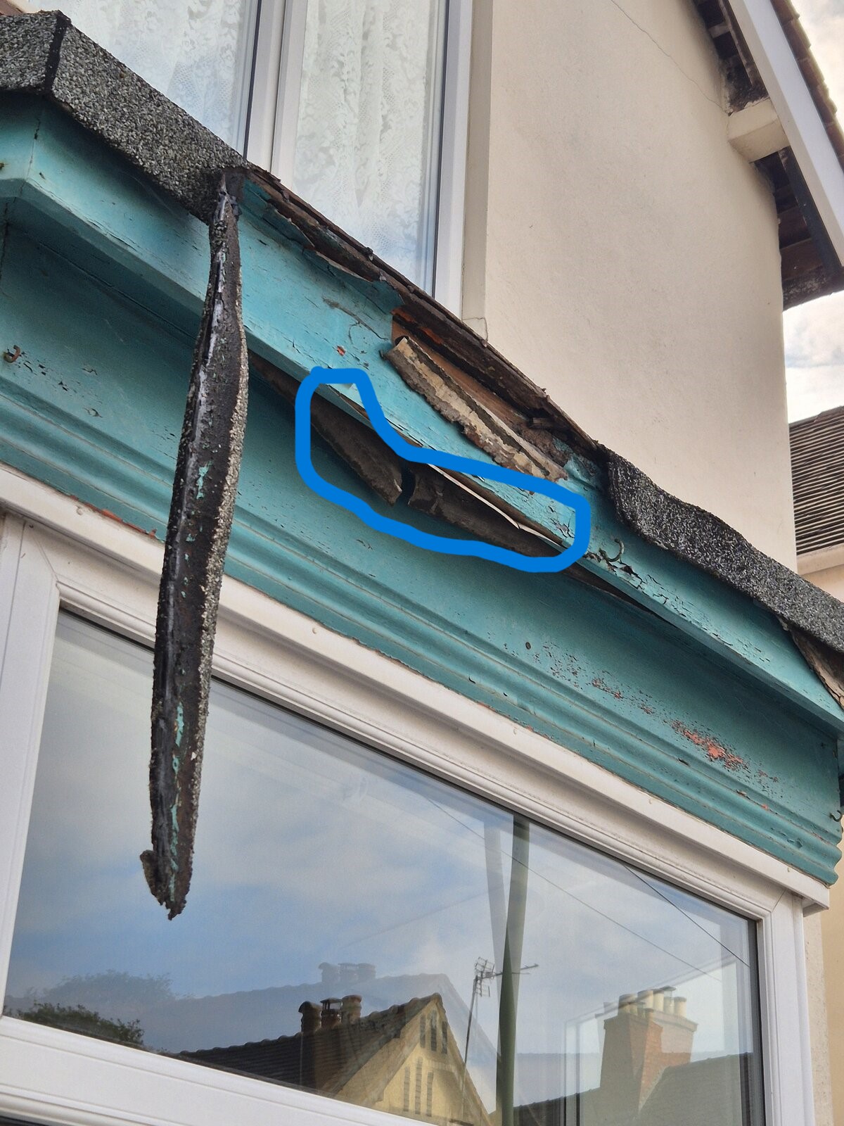

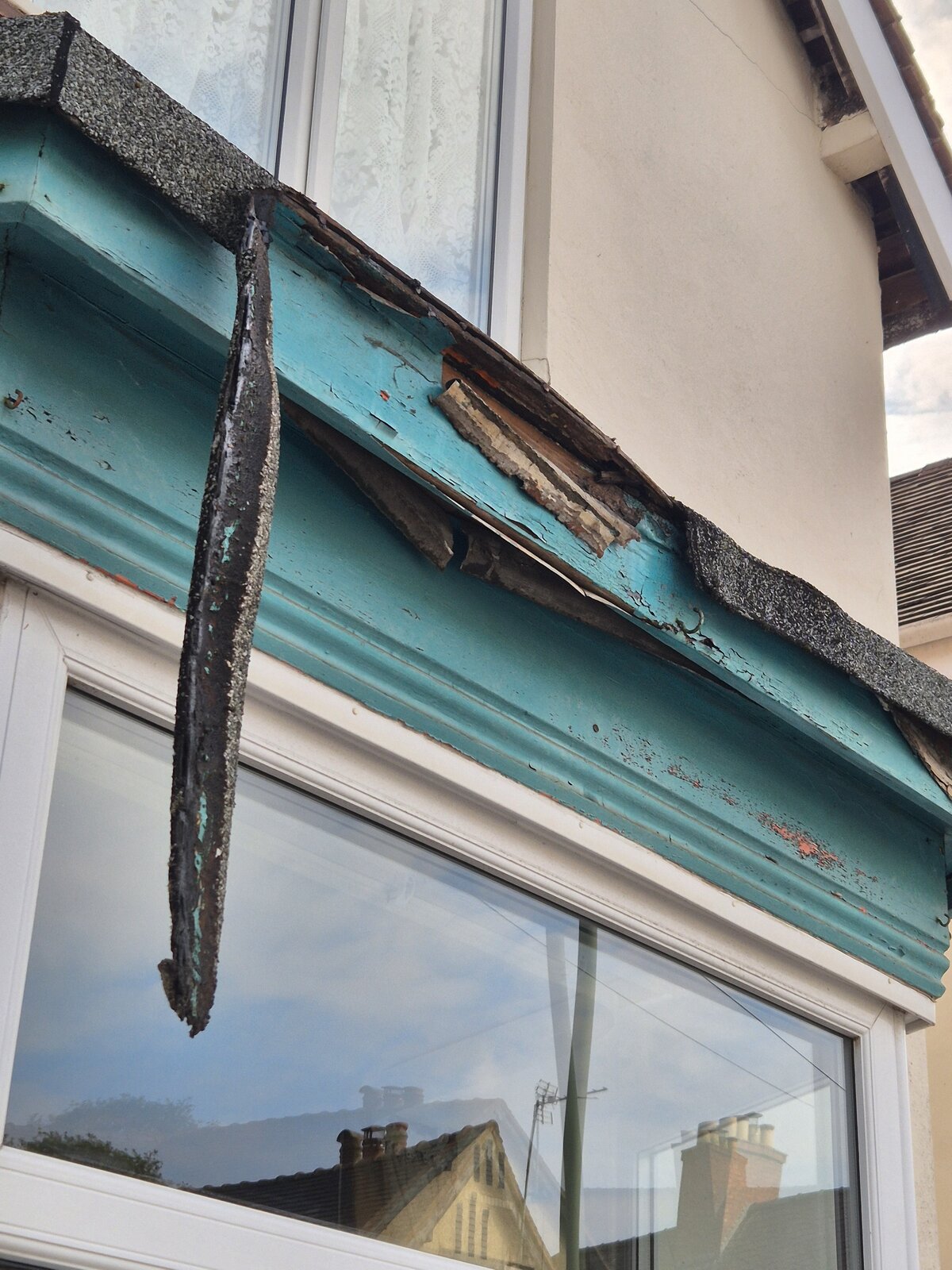

This bay window has been neglected for some time. And surprise surprise it now needs some repair. I'm guessing as a minimum refelting, probably some replacement boards, and maybe replace the wooden facia for upvc.
had a quote for £2,000 with scaffolding required. Seems a little excessive. Obviously getting a couple more quotes and will see.
And yes, I know, the rendering needs doing as well.

The timber doesn't look that bad. I cannot see any obvious signs of decay from the photo. By that I mean the green painted timber. I don't understand why there seems to cement between the facia board and upside down skirting.
Scaffolding? Someone is taking the pee. A tall step ladder would suffice.

We have one, not quite the same, but similar. Last year, I spotted a guy down the street, changing one, from a felted roof, to a tiled roof, with the timber framing, and tiles. So I asked for a quote - £350 was the amount quoted.
Thanks for the replies. Yes I thought someone was going a bit far with needing scaffolding.

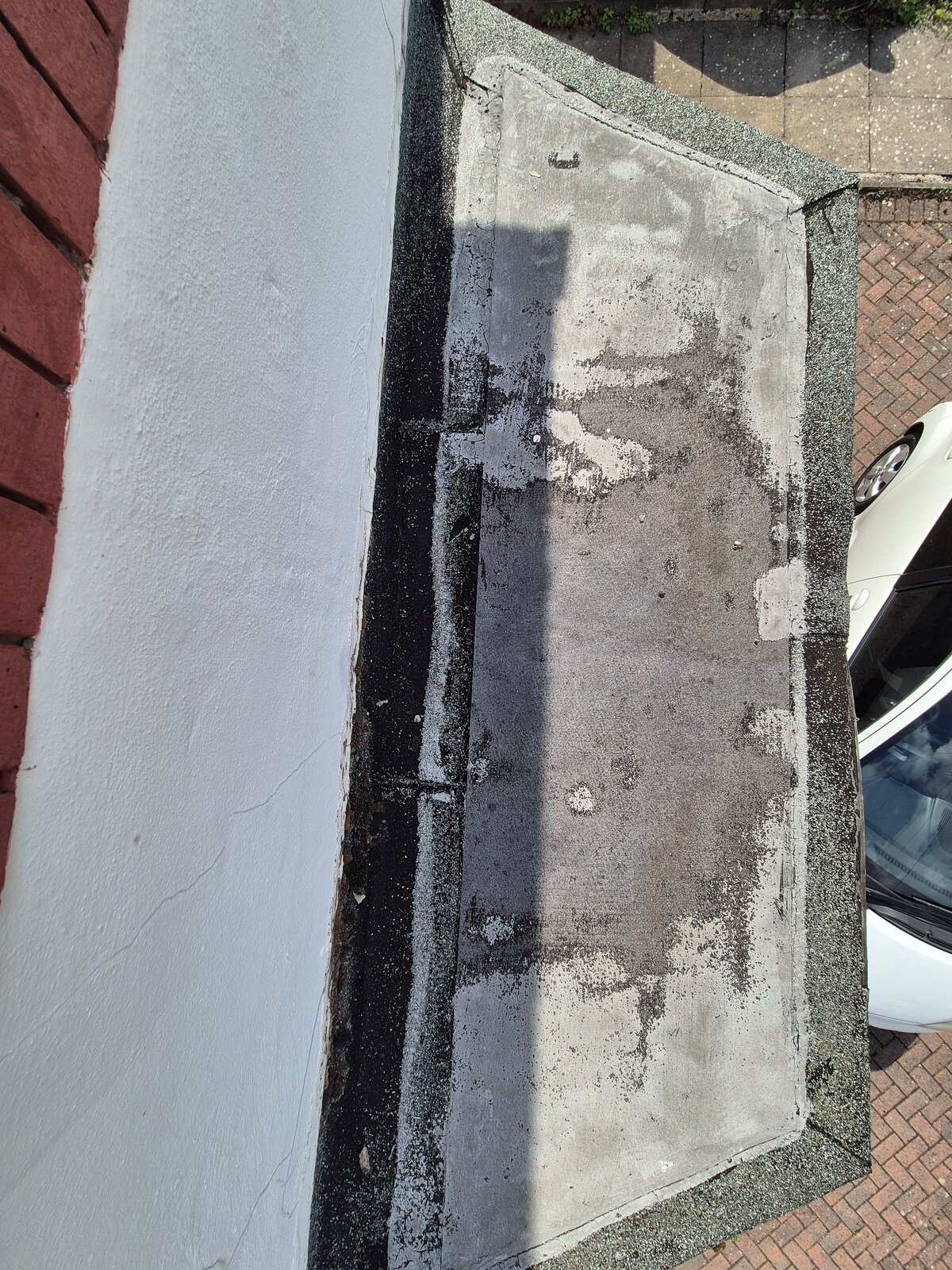

Just to answer a couple of points. I am the homeowner, and there is no damp on the inside. And attached a picture from above.
I dont think it is cement between the fascia and upside down skirting. Not sure what it is tbh bit maybe the wooden fascia delaminating.
Just had another quote for £850 thats to refelt it and replace the fascia like for like with timber. The upside down skirting bit doesnt look too bad so may be able to just tidy that up and repaint

On my laptop, it does look like cement. But I could be wrong.
From your last image, it looks like the felt was fitted retrospectively. Hence the ridge.
It is outside of my comfort zone but I think it might be prudent to have guttering fitted. That said, it is only a small area.
Hopefully other members will be able to advise further.
As a decorator, I cannot see anything seriously wrong with the timber.
It may well be the case that the "decking" (ply?) needs replacing. Or it may be the case that, if sound, they can use tin, or more felt and new flashing.
If the fascia doesn't need replacing, I am inclined to think that the new price, whilst better than the previous one, is still possibly high. That said, it is a small job which which (in theory) will require multiple visits.

@Ben565 If that was my bay roof, I'd remove the lot and replace with a pitched tile job to match the main roof, and then fit gutter + downpipe to it. All flat roofs eventually fail but pitched tile jobs last a lifetime.
There appears to be not much height difference between that roof, and the window directly above it. It might make the roof pitch extremely shallow.
