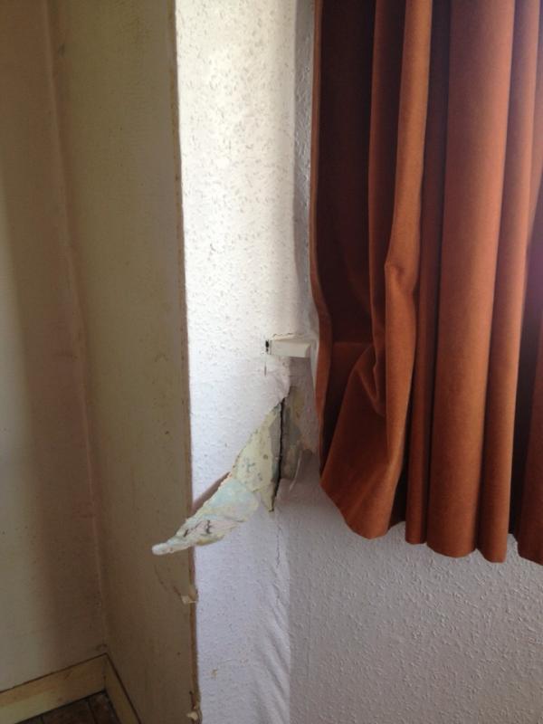

Hi,
We are in the process of buying a new house and the home buyers report has highlighted cracking in the upstairs bay window wall at the front.... The surveyor said it was by no means uncommon for this to happen but it may need "tying back" he said it was because bay foundation were never built to the same standard as the main house foundations... The house is a 3 bed semi from the 1950s.... Just wondering if anyone could advise

I think dann meant to say; It's extremely common for a 1950s bay to pull away. (In fact it's almost compulsory.)
Otherwise I agree with most of what he says. Those bays were often not well tied to the house and often had inadequate foundations. How much to put right is very difficult to say? Some ties and making good could be less £500. If the foundation needs pinning or rebuilding it might be £5k+. You will need somebody to properly inspect and report on it to know for sure.
But bear in mind that it is very common and actually not that many get properly repaired. Most people just do a bit of filling and making good and live with it. But be prepared for the fact that you will be facing the same questions from a future buyer. In view of that you might want to negotiate some money off - which will compensate you for when somebody negotiates money off you in the future.

I got a couple of people who know what they are looking at, rather than builders and surveyors, and they all said the same thing.....
Unless you can get ur fingers through the crack, don't worry, also the wall which recessed around my bay, as in the photo, was made of plaster board, which then met the solid concrete/brick framework of the house.... And where drywall meets brick then a crack is likely after time, but nothing to worry about
If it's the same as a 1930s ie; a wooden frame which is rendered on the outside and lathe and plaster on the inside, I repaired a few now by removing the lathe and plaster, squeeze some rockwool or similar between the timber frame, then uing three inch screws affix marine grade 22mm ply or similar, screw to as many of the timbers as you can, this will hold the old timbers together hopefully, then on top of that screw your plasterboard to the ply, plenty of scrim and it should be good for a few years or more.
NB. This is the upper bay, the lower bay is normally brickwork.
