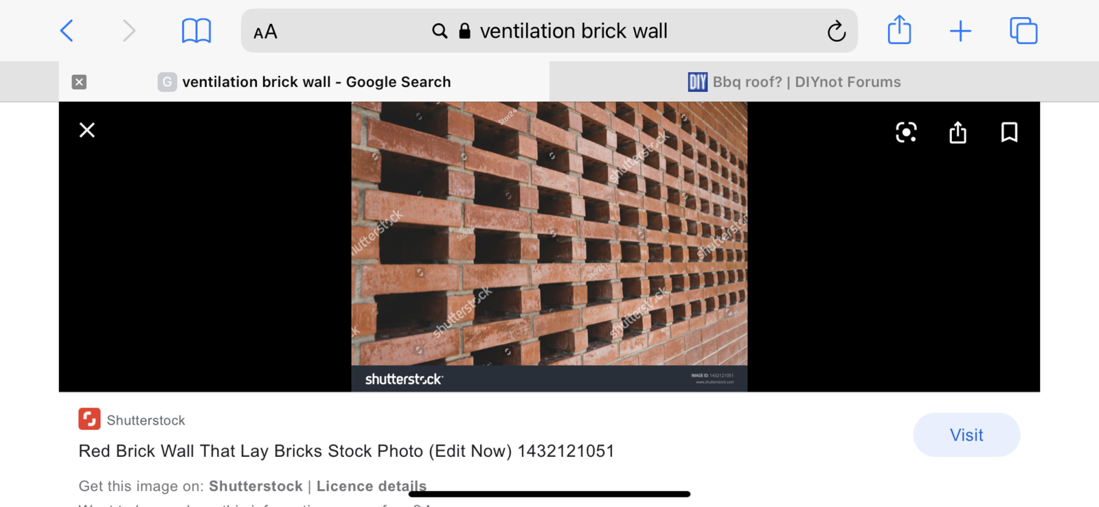

I might get the builder to do the below in the top of the retaining wall. Give it some airflow. Other than that I’m out of ideas
a chimney (once it has warmed up) usually draws the hot air up and out the top.

just ventilation. I think I’ll ask builder to put some ventilation into the wall as above. Least it’s like having the window open. Then if I need more I’ll add a normal stainless hood too.
