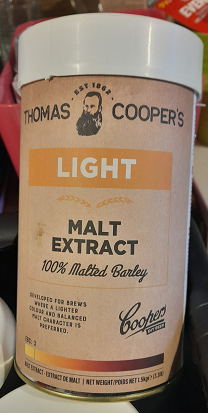

Have I really been making home brew for that long? Well on moving house I lost my brew fridge, but by then I had worked out I liked Scottish Heavy, and I just pour in the can of stuff, add 1.5 Kg of sugar wait three weeks and bottle it in old pop bottles. I have a heater under the fermenter, and thermostatic control, and since no fridge, stop brewing in the summer.
But a holiday to Scarborough resulted in my buying some cheap kits. One can has no instructions, and no yeast, latter not a problem, but not sure if this is brewed as it is, or if it replaces sugar with another brew.
1761151327431.png What should I do with this? The white cap I put on to keep some yeast I have with it.
