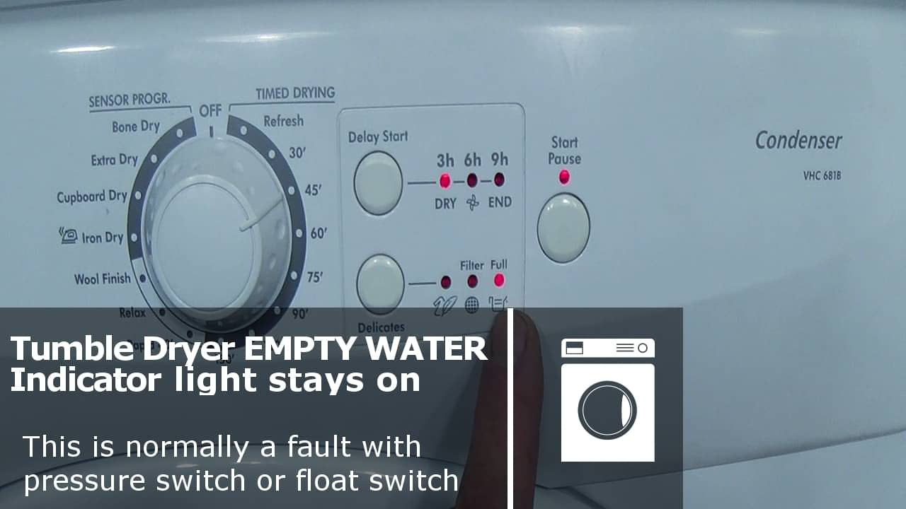

Not sure if this is any hekp
or this
If all else fails it seems you can bypass the tank and just drain the water externally rather than replacing the dryer.

Lot of steps in the youtube link not necessary. Guy is all over the place.
If motor does not run, check the motor for continuity or rotor jamming
Then proceed from there.
Bit dangerous to handle live wires as shown n the video link.
They were insulated spade connectors but obviously not as safety concious as we would be in the UK
