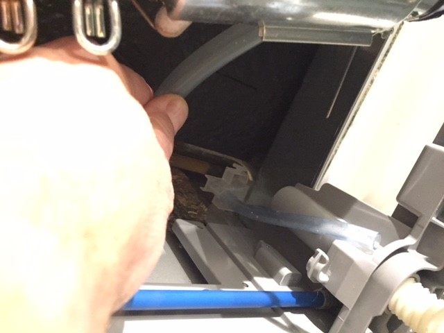

Beko DW 603. Anti flood micro switch activated as undertray full of water. Tray emptied and no evidence of leak found.
Machine switched on and inspection performed from front right, behind panel that is below door. Leak shown to be originating from 6mm clear drain pipe clipped to inside of right side panel adjacent to front right lower corner of machine. Unable to ascertain what the fitting is that the other end of the drain pipe is connected, as it appears to be faulty and hopefully replacing it will cure the problem (see pic)
...…..unless of course someone on this forum knows differently. Pete
