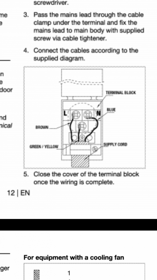

Thanks for the help people, it is wired to a standard plug which fits into a electrical socket and not directly to the mains supply.-,
Here is a link to the wiring digaram pdf
The control knob could be faulty, thus not sending power to either circuit. You still need a multi meter and the knowledge of how to check it tho.

Thanks everyone for the advice- fitted a new element and fan on it yesterday (amazon prime £18),and works like a dream
