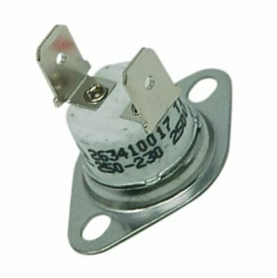

Hi - so it seems like my oven has died. While the clock and timer functions work perfectly well, turning the control knobs neither turns on the light or fan inside the oven, nor does any heating begin.
Can I ask what this might suggest as a point of failure, perhaps something not as simple as a replacement element or fan, given the light doesn't even go on? Anything I can check with the oven unplugged and pulled out?
Thanks for any advice.
https://www.beko.co.uk/single-fan-oven-oif22300-stainless-steel#support
Hi, I've just had to replace the Cooker Oven Limit Thermal Cut Out Thermostat, on my daughters Beko oven, last week. You need to do some circuit tracing, but the failed unit makes for a'dead' set.
Hope this helps.
