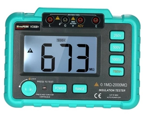

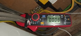

Two tools, Diffrence line neutral 8 Feb 24 reduced.jpgVC60B.jpgcan help find the problem, both cost around £35 for cheapest, and need skill to use, the insulation tester is likely the best of the two for finding the fault, but likely better to get an electrician who both has the tools and knows how to use them.
