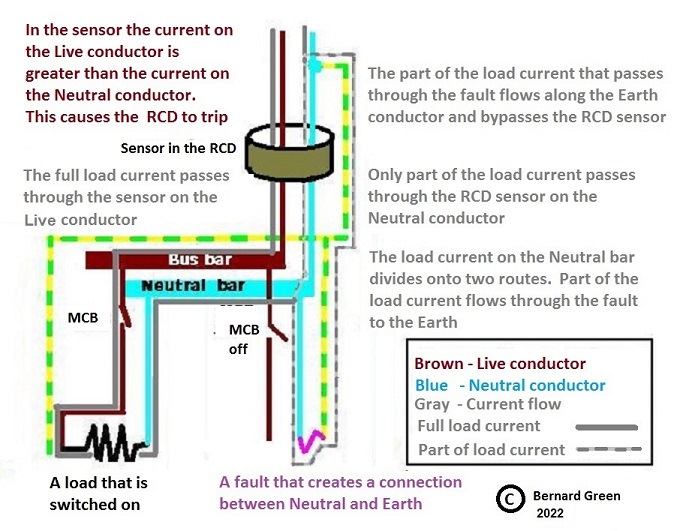

OK, just keep in mind that the MCB's, will only isolate the L, the N in each case remains connected and leakage N to E can also trip RCD's.
It is possible that a Neutral to Earth fault on another circuit ( not the oven circuit ) is creating a mis-match at the RCD when the oven(s) are drawing current.
These can difficult to locate as it requires testing for Neutral to Earth in every circuit on the RCD
The oven(s) being the load
