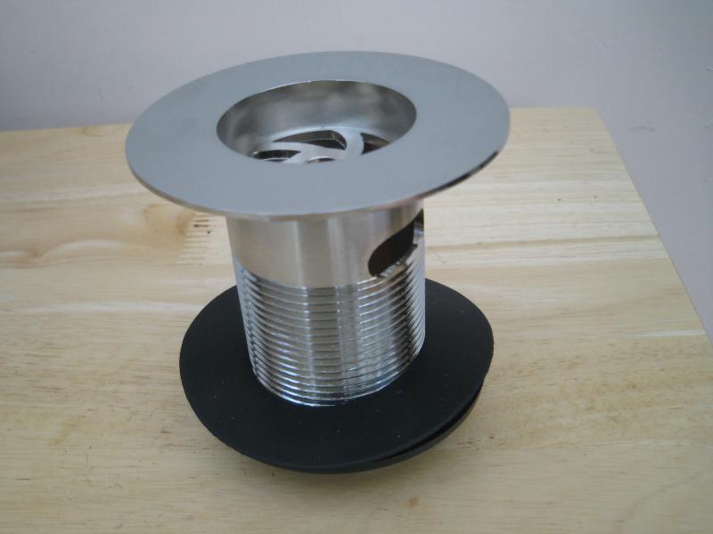

I've read previous forum entries re Belfast sinks but can't find the answer I need! I bought a 'suitable' waste from Plumbase - it has two holes for the overflow. I only have one overflow in the sink. How do I stop the water going out of the holes? Also, if it's possible to get a waste fitting with only one hole - how do you seal the hole in the waste fitting against the overflow hole? :( ;)
I thought that all Belfast sinks had a built in overflow?
I also thought that genuine wastes for Belfast sinks had no seperate overflow inlet?
Possibly what you have been sold is just a wider waste for use on some stainless sinks with seperate overflow connections.
If I had to deal with blocking an extra inlet or two I would just block it with one of the plugs that come with new boilers and seal it in position with sealant.

this is getting confusing. I have an old belfast sink with an overflow. Attached is pix of waste fitting I have bought. This has two holes (one can be seen, the other is opposite) to take water from the overflow. I don't need the overflow to work as the sink is outside and overflow is unlikely to be a problem. I think that if I fit this fitting the water draining from the sink (not the overflow) will escape through the holes in the fitting.

providing you seal the washer and nut when fitting it will be ok. same as a basin waste. or use a not slotted waste.
Do not, under any circumstances, use an unslotted waste on a Belfast type sink if it has a built-in overflow.
Gunk will collect between the sink and the threaded tail. It will then rot and stink more than you can believe.

By look of it you actually have the correct waste, the previous post was right to say,not to use an unslotted one as it does gunk up and stink! ( been there and done that courtesty of a plumber who thought "it would do"!!).
The holes are not to let water out of but actually to let wth water into. if you look at the bottom of your belfast sink there should be a well area, so that as water flows into the overflow at the top of the sink, it runs down into the "well" area, back through the holes and then down through the waste tail. Therefore the holes should sit between the two layers of the belfast sink waste and then the nut will create a water tight seal leaving the rest of the tail exposed to connect the trap to.

Jenny - thanks for the help. I guess I have to fit it and see what happens. The waste 'tube' part is smaller in diameter than the sink hole, and there is no well in the sink hole (already checked that one out). Still, I'll let you know how I get on.
