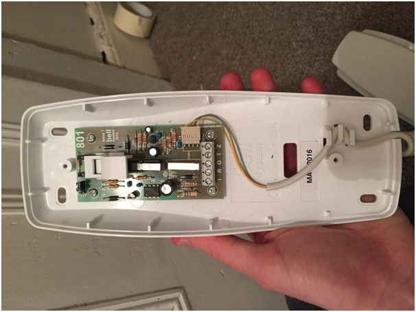

Hi,

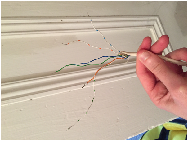

I recently moved into a flat and the buzzer isn't hooked up. The previous owner left a handset and the wires are there but I have no idea which wire goes where. Can anyone help?
Can you have a look at one of your neighbours handset wiring ,the handset may well be different but it will be a start to sort out where the wires go.
The wire you are holding,were any cores twisted together ?
Do all the wire ends have the insulation removed ?
Are there any screw marks on the end of any wires ?
Only options without blowing the transformer fuse is ...A look in another handset ( best option ) or B look in the entry panel and take note of the colours
Cheers, I'll ask for a look at my neighbours. The wire was exactly like that when I moved in.
Just a point is it the same handset as the others. Plus post a picture of the entrance panel . There's been that many posts on here with people thinking they can fit any handset on any system !
