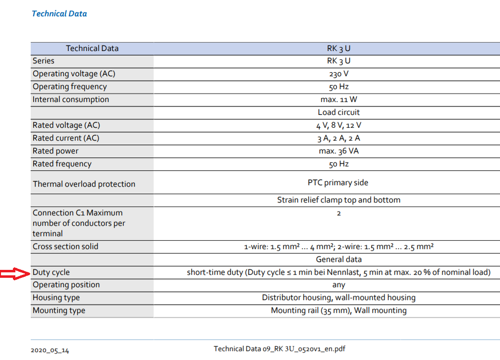

I have replaced previous 8V transformer with one that has 8V, 12V and 16V taps and rated 8VA.
Actual voltage from the transformer on the 16V tap is around 18V, 14V from the 12V tap and 10V from the 8V tap.
