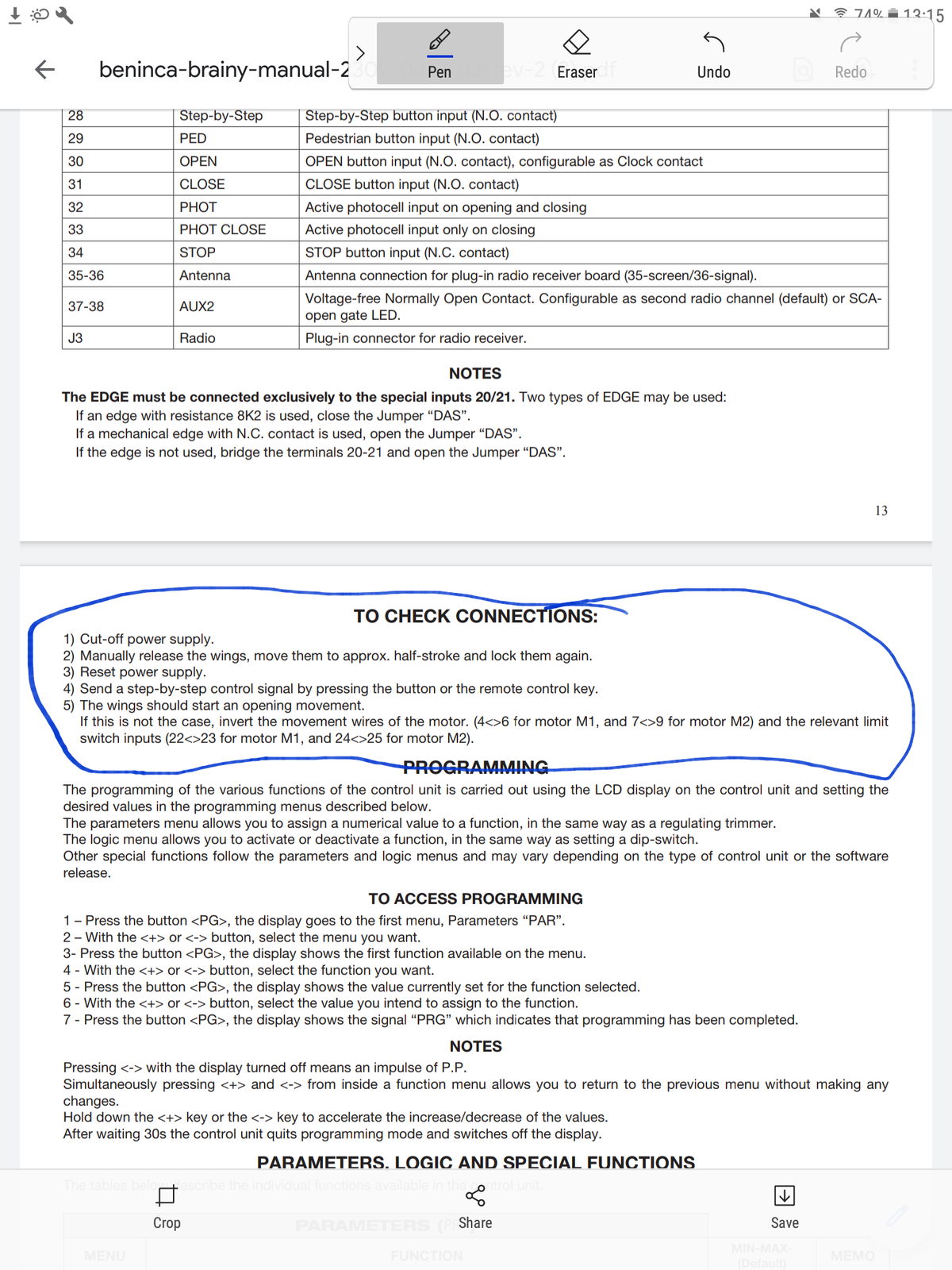

Hi,
I have a set of BENINCA CAB HD18.AC gates with BENINCA Brainy control unit. One of the motors developed a problem and i replaced it. It is working now but the gates open in opposite directions. Any help would be much appreciated. Thanks so much in advance.
Screenshot_20210515-131544.pngIf your gate operator is 230v version, then you may need to check the motor wiring connections.
