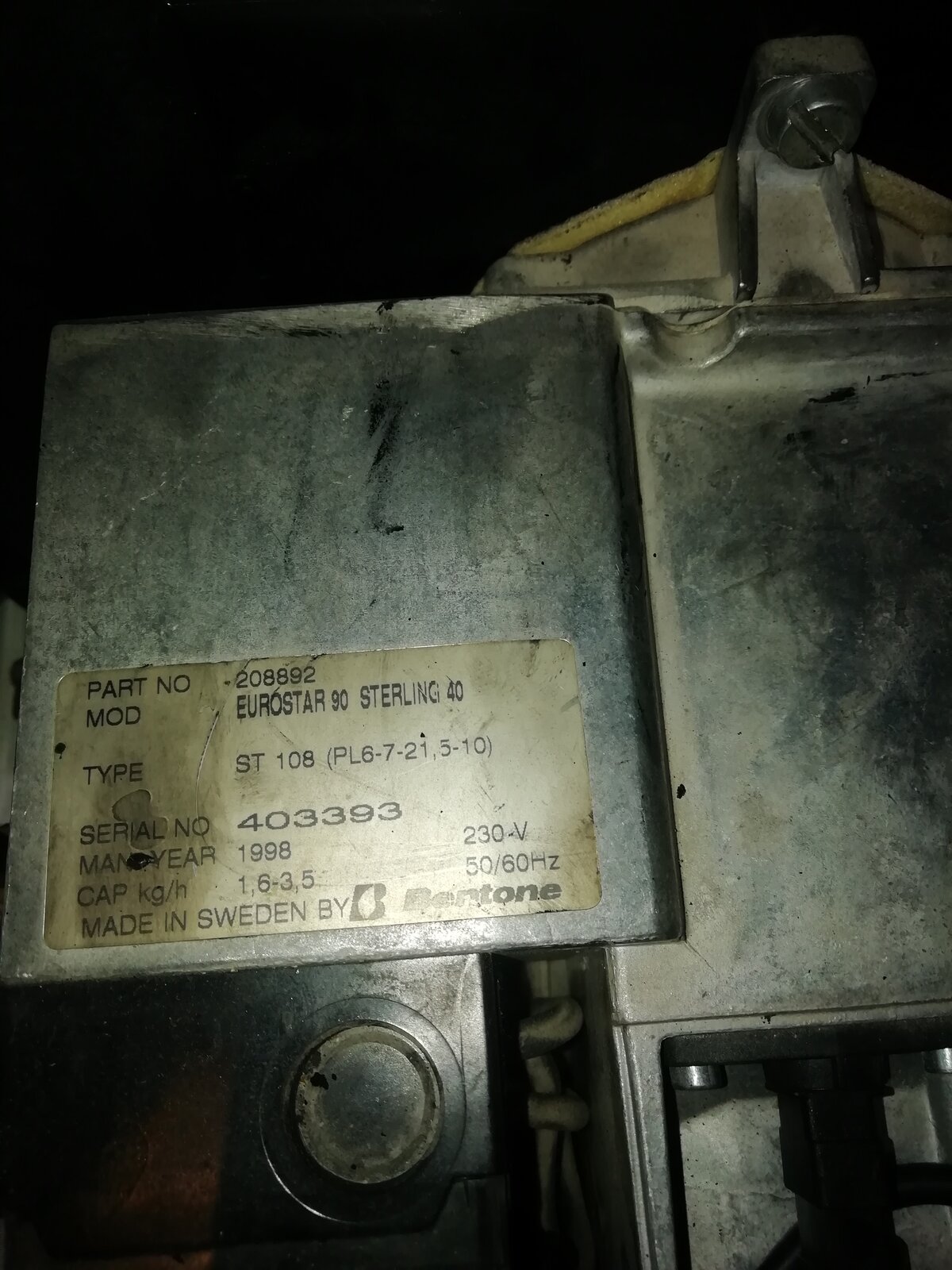

I have just serviced it and cleaned up all the soot since last service year ago .It supposed to run at 115psi but unless its at 175psi it locks out. This is the pressure it ran for for the whole year. New nozzle. Electrodes set correctly now. My question is why does it have to be so high? Its sooting it all up after a year.
28 or 35 sec fuel,
boiler model and output and nozzle sizes .
FGA readings
Hi. Thanks for replying...Its a Trianco Eurostar 90 Utility. Output 26.4kW 90.000 Btu/h. Nozzle 0.85 80 EH. 28 sec fuel
'85 @ 12 bar is about 40 kw input. so waaaay over gassed.
check burner rating on data plate .head settings etc. could be wrong burner.
what smoke no is it ? FGA readings ????
The burner was fitted to boiler when I moved in some 10 years ago. Dont suspect that as the problem. As it has been sweet. Im not able to get FGA readings as dont have a gauge. I can tell you that it doesnt omit black smoke at outlet (chimney) whioch I thought it would of done
with that amount of fuel passing through. Photo attached of burner data plate.
Try dropping oil pressure to 8 bar and reducing air shutter for clean burning.
the soot is unburnt fuel probably caused by impingement..
Absolutely no chance. Had to turn it slightly up in increments to get where I am. So even a 5psi drop will drive it to lock out. I might buy a new pressure gauge to see if its out that badly. Any other ideas or input would be appreciated.
