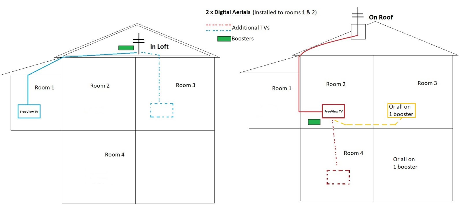

As you can see I have 2 fixed digital aerials (both the same models) supplying rooms 1 & 2 (Both supporting freeview TVs) In a domestic Victorian style house. Merseyside.
I would like to know the best or correct way to extend their feeds to at least one extra TV each (FreeView) or Just one to multiple TVs, as I'm not sure how digital signals should be dealt with rather than the old UHF.
(Years ago, I would've simply put a 4-Way booster from the loft aerial to supply other rooms)
I don't want to get on the roof to add a booster close to the aerial so let's rule that out please (my signal percentages are ok too)
I was imagining I would have to add 2 X plug-in digital signal boosters (or are they just boosters?). One in the loft and one in room 2. Or could/should I simply just use splitter blocks; OR option in Room 3 below; or non of the above?
Anyhow any info for the correct configuration and parts would be of great help.
Room 1 Scenario is approx 11M total run (5 & 6M runs from booster)
Room 2 Scenario is approx 15M total run (5M from booster to additional set)
Room 3 Scenario fed from room 2 booster because it's from a roof aerial, which
I suppose receives a stronger better signal and saves time and money ?
Run in coax 2 years ago Webro.com black outer sheaf followed by silver strands and silver foil before copper tip, and will use the same for additional runs.

With amplified splitters the best way is to have the unit as close to the aerial as possible. That will provide the cleanest signal to the amp, and from there to the TV. It doesn't have to be on the mast. The amp.can be in the loft.
If you're going to split at the set back (and provided that the signal is strong enough and of high enough quality) then use a passive splitter on each.
Passive splitters introduce no noise. However, they don't amplify the signal either, so an excessively long cable run from the split point to the next TV won't be compensated for if that's required.

Am I right in thinking it would be best to use a 3 or 4 way passive splitter behind set back supplied by (Roof aerial going to room 2) to supply 3 signals to 3 TVs.
If I get weak signal or loss of channels at any of the other TVs, then replace 3 or 4 way splitter with a 3 or 4 way booster?
I Just wasn't sure how digital signals share output when split, and thinking of it like water in a pipe.
Best to have 2 open taps on 2 separate mains feeds, than three open on one main, if you get my thinking?

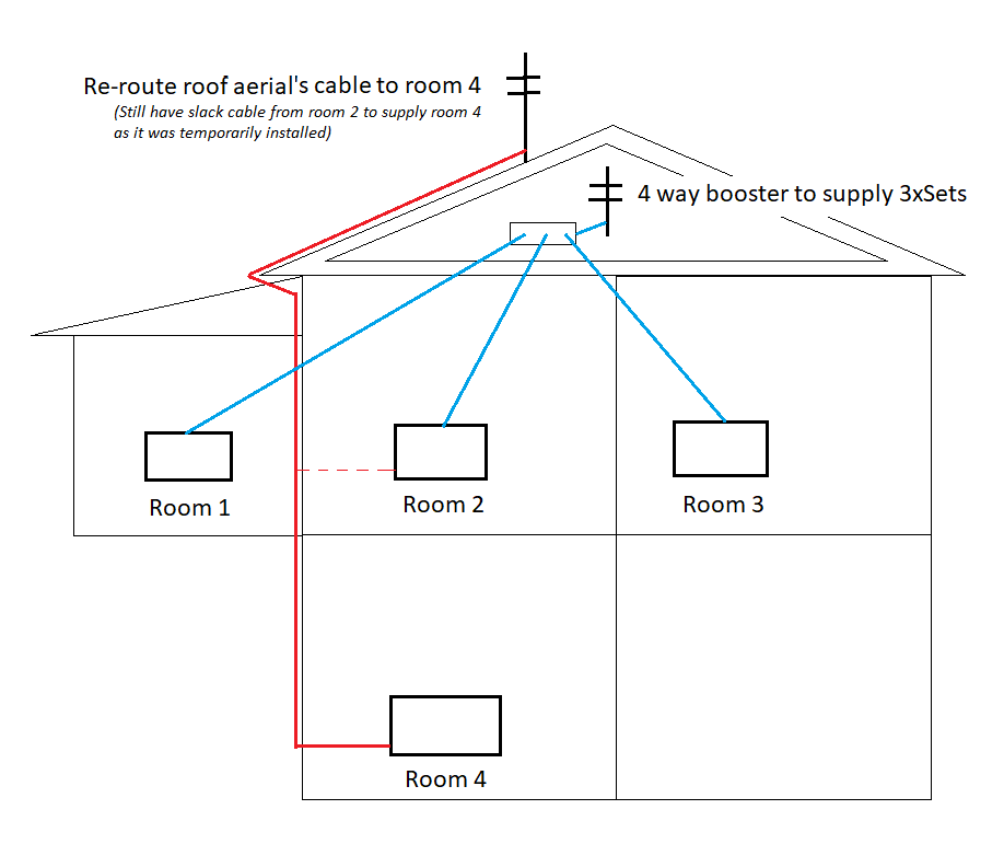

I think I will heed your excellent, informative and extensive advice Lucid and go with boosting the loft aerial to 3xsets. Yes the signal quality should no doubt be better from the roof aerial, but for safety, neatness and cost effectiveness it makes sense to go with the loft aerial option.
One point I'm a bit stuck on is what 3 or 4 way booster/amplifier? should I be looking at, as I've googled a few that look very different and I don't want to make a mistake of purchasing a wrong type (if there is such a thing).
Could you post a handy link for one or more recommended boosters/amplifiers to reassure me please?

Try a passive splitter in the loft first. Better still put a passive splitter in room 2 from the roof aerial and feed the other TVs from there.
No point in wasting money on a booster that I doubt you need, and have problems getting power to it in the loft.
Yes as you have both stated a £6 splitter could be sufficient, so I suppose it's the sensible thing to do first. Worst scenario, £6 loss. Thanks Winston.
Roof aerial - Kept in Room 2 - Passive splitter - Single fly lead to room 2 set - No pixelation or break-ups - Good for other 2xRooms supply.

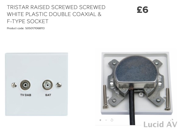

I bought the splitter today and decided to get a TV outlet Although both feeds are NOT from cable TV or a satellite dish: can I still use a satellite outlet to link to my freeview TV?
The guy in B&Q told me it wouldn't work as I needed a decoder? But I have installed an outlet for another set with the female F-Type screw on fitting from the loft aerial and it works!
Not sure if I got lucky first time and it's some sort of TV outlet but with an F-type fitting, but I ended up getting the normal TV outlet on the assistants advice.
Can you advise or paste a link if there is a female F-type TV outlet for the job (can't remember where I got the last one) But they are better as a connection, especially as the tv will be
hung on a canter levered extending bracket. If so I'll exchange the one I got...Thanks.

It does depend on what it looks like on the back. If it's something like this Tristar twin output socket then the answer is no.
The big silver lump is a frequency filter. To make proper use of this type of socket there would be an aerial distribution amp that includes an input for a satellite signal. The amplifier combines the two and sends both signals down single coax runs to each TV point.
The wall plate such as the one above then de-combines the two signals. What you then have is the aerial signal only on the TV socket, and the satellite signal only on the Sat socket. As a result, there's no TV signal to be had from the Sat socket. In this respect, the person from B&Q was correct that for this type of wall plate you'd normally be connecting the Sat output to something with a satellite signal tuner. In most cases that "something " would be a satellite receiver or a TV that has both a Freeview tuner and a Freesat tuner.

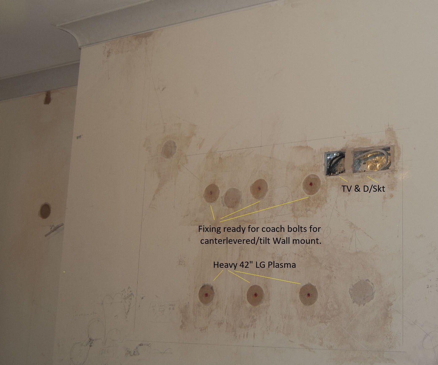

Are you hoping to have the cables concealed in-wall with a wall plate hidden behind the TV? If so, there might be a better and more flexible solution.
Sorry for the late reply, and thanks for all your very kind input. In answer to Lucid's questions about face plate design/configuration...The outlet I was querying at B&Q was just a single F-type skt with "SAT" written above it. It was in a box and there was no view of the back of the unit, I also didn't have my reading glasses to see any small print. It made me question it before purchase as my other TV outlet (F-type) that I had previously installed didn't have any wording on it., ergo the need to ask a staff member. Typically I have mislaid the original receipt for the push fit plate, so will have to bite the bullet with that purchase, as I do want something better than the push fit type especially as the TV will be movable.
I would like to hear your more flexible solution though Lucid?
Coax to a single skt box for TV Outlet plus D/skt..
