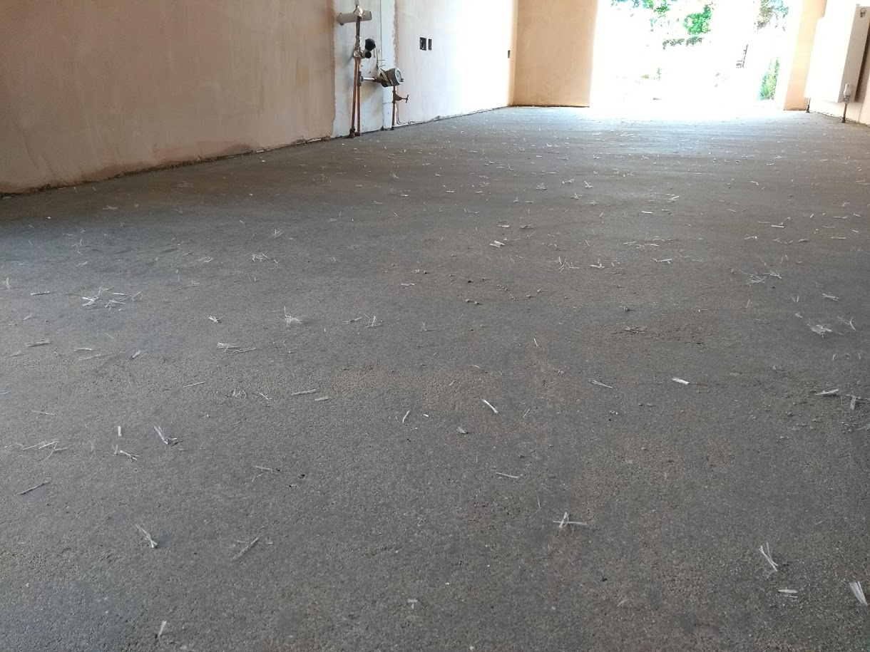

Had a quote for vinyl sheet, and with levelling screed it is about £1000.
The concrete screed is very smooth, great job, so I could probably easily DIY it.

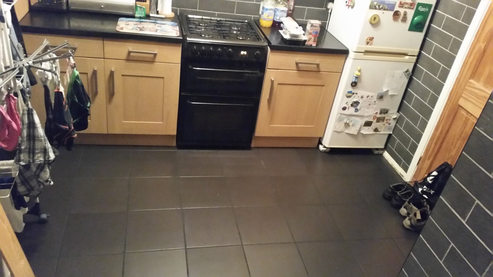

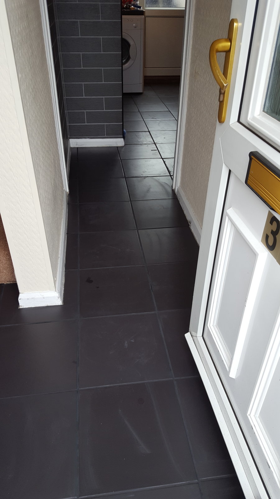

I tiled our kitchen floor, was hard work because of leveling (which yours already is).
Best decision I made, hard wearing and you don't have to worry whats been spilt on it etc. Quick sweep and mop and good as new!.
Used hand mixed tile adhesive, not premixed dross and BAL Micromax (2?) grout which is and excellent product!.
Had laminate down before but was never happy with it.

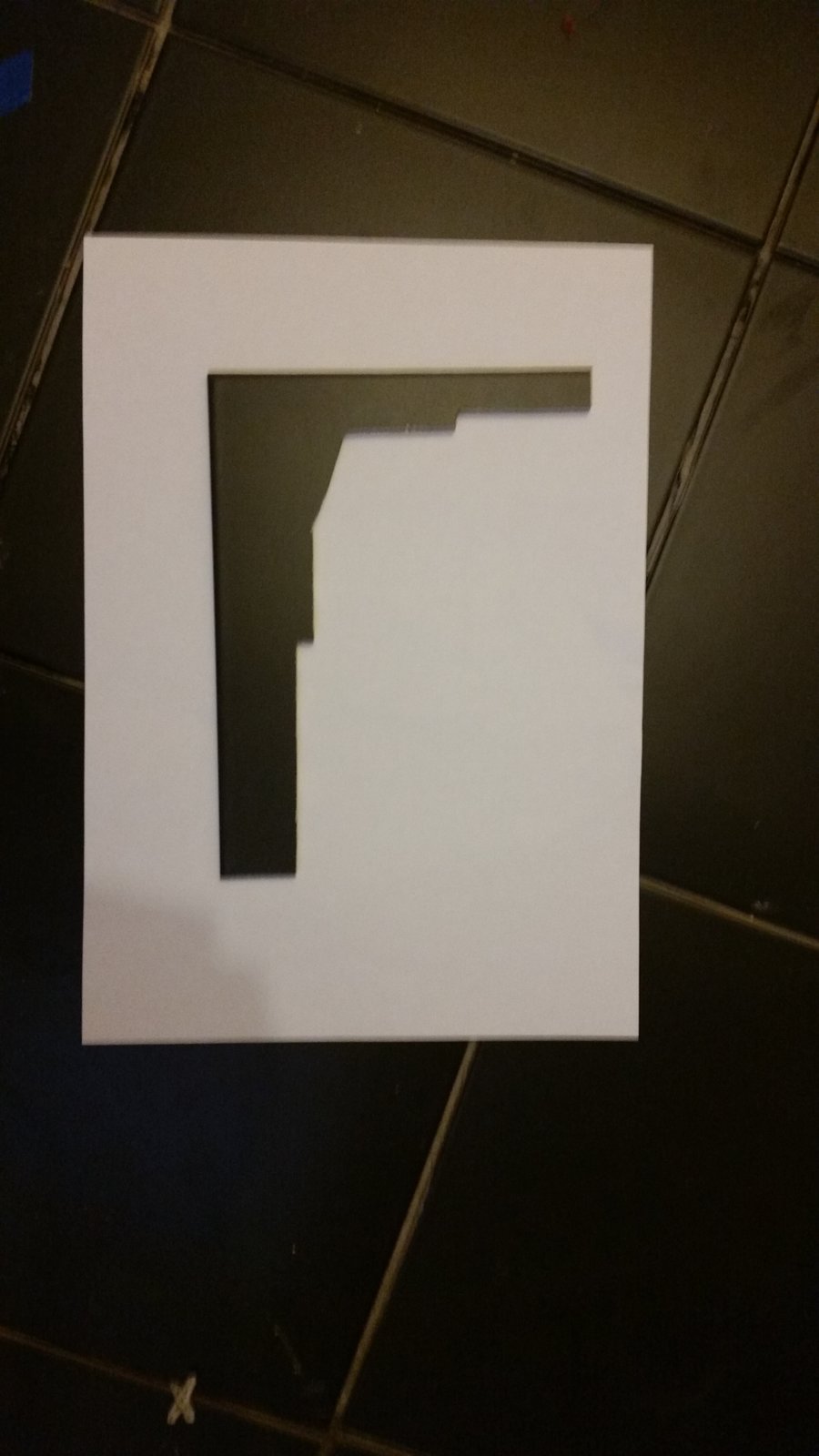

how was the cutting of the tiles?
my floor, laid this morning ...

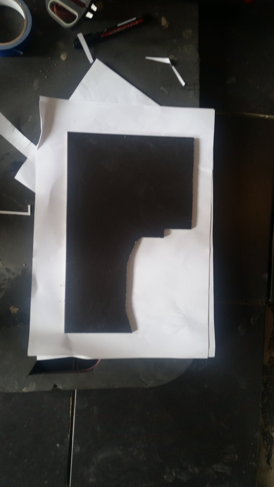

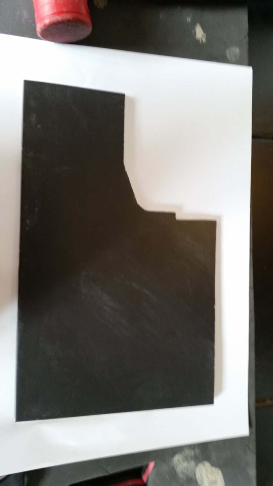

I used a tile scribe and snap cutter for the majority, a water fed tile saw for some tricky ones and also a diamond wheel on a dremel.
Get all the full ones down first then take your time with the cuts.
mind you, tiles are a lot more expensive?
£300 for all the tiles and adhesive at B & Q iirc?.

I hope the firm who gave you a quote for £1000 was allowing a liquid dpm in their price as it will need one with the concrete screed being new.
That might be a winner then!
How to fit - just put down a underlay and put them in place?
Any gluing to do?
yes, was a liquid thing going down, green. I think.
No gluing
Get some airflow going on in the floor to dry some moisture off it.
Use a dpm underlay.
Timbermate excel and timber tech silver are good but not cheap.
all doors are open. No rush on putting the kitchen floor down though, will get it decorated, kitchen installed etc. before thinking about it. Should leave it about 2 months if putting DPM over it I think.
