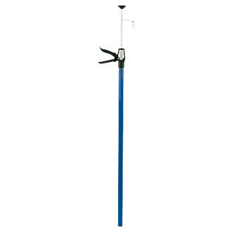

One of these under the drill would do the job.
