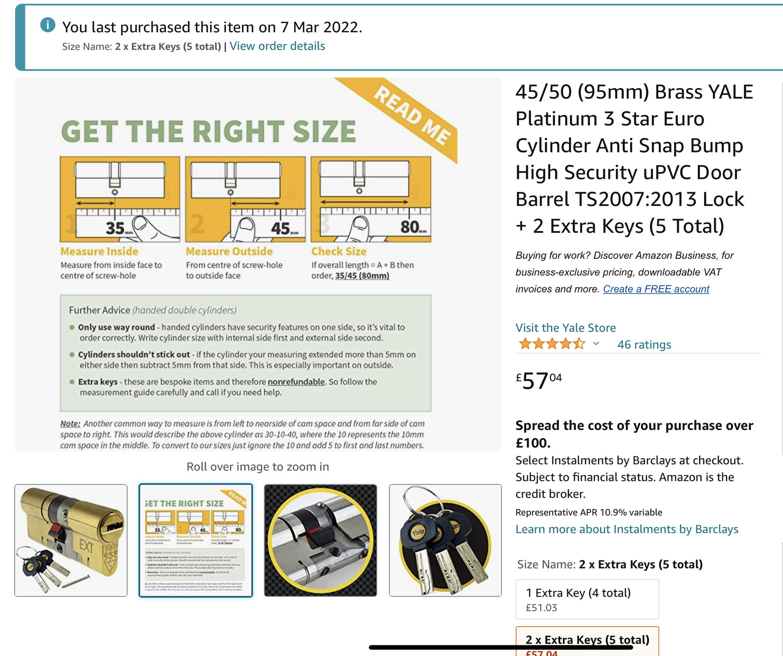

With the Yale they give sizes like 45-10-45, is that still 45 to the centres and just noting the latch is 10mm wide?.

When a manufacturer quotes the 10mm in the middle it means they're not measuring to the centreline of the screw hole but rather to the start of cam and they're pinching 5mm from each half and lumping it in the middle so a 45/10/45 is actually a 50/50
Yes it's weired really, I need some 35/55's (or a 30/10/50 Yale).
I think the new Yales us the "normal" sizing.

Those Yale ones you've bought look good Mottie, I'll see if they do a 35/55 (in/out).
