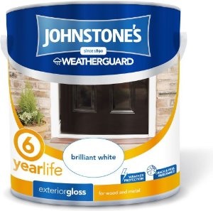

I can say one thing for sure, that Johnstone's exterior paint is well worth the buy.
It's not as expensive paint either, but applied correctly it has a long life.
