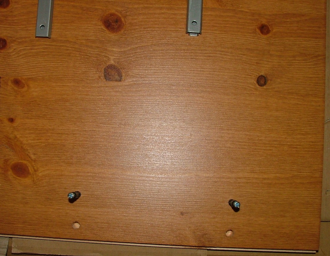

Yes it is basically held together with dowels and those bolts/cam things. For example: on a wardrobe, where the sides join the top, there is a cam/bolt 35mm in from each edge and a dowel 70mm from edge. (Also a cam/bolt in the middle but no dowel). And on some of the smaller parts there is only one dowel and one cam. I will definitely glue the dowels in place, but I still think it will be a bit wobbly.
I'm wondering how I could sand the hidden surfaces without straying onto edges that will be seen? Where the sides join the top won't be so bad, but the bottom joins the sides about 2 feet up as there are draws underneath. I'd only have a maximum 15mm strip that would be hidden.

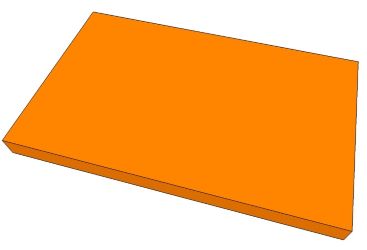

Edit: Quick and Dirty Sanding Board - @Peter67 take an offcut of flat sheet material, in this case I'm imagining an end offcut of kitchen plinth about 250mm long x 150mm wide but the size isn't critical, all you need is something flat, ideally about 15 to 18mm thick an with one straight (factory) edge:

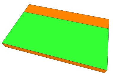

Glue some sandpaper onto it. I use contact adhesive or spray adhesive because I always have them. In this case the (green) sandpaper is standard 114mm sheet width, but that isn't important. All that matters is that it goes to the straight edge:
If your sandpaper laps over the edges just trim it back with a Stanley knife. Get another piece of straight material and screw, pin, nail, hot melt glue it onto the sandpaper about 13mm oin from the edge and parallel with it (in this case I'm imagining a piece of 2 x 1 PAR softwood battening, in reality anything with one straight (planed or factory) edge will do:
Now you have a sanding board which will accurately sand a flat surface no more than 14mm in from the edge, hence "sanding carefully"

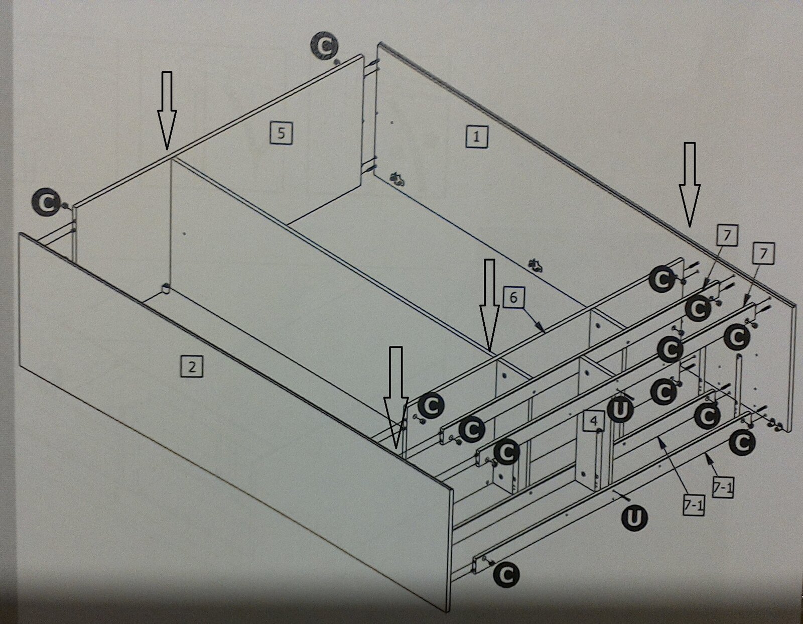

If I've understood correctly, I can see how it will be very useful for doing the ends of the boards. In the diagram below, I can use it to sand down the top edges 1 & 2 for where they join onto 5.
Problem is, like where 1 & 2 join onto 6, the part that need sanding is through the middle of the 1 & 2 sides.
And the same where the divider joins in the middle of 5 & 6. (Arrowed).
Just wondered if you can think of an idiot proof way I can prepare these areas for gluing also?
TBH I think there is none. For those, where it looks like you have a dowel and a cam/peg (?) at the end of a narrow rail I'd just glue the dowel in the holes with a spot of PVA on each end. Don't over glue - believe it or not it is possible to split narrow chipboard components by hydraulic pressure if you use too much glue (don't ask how I know that)
