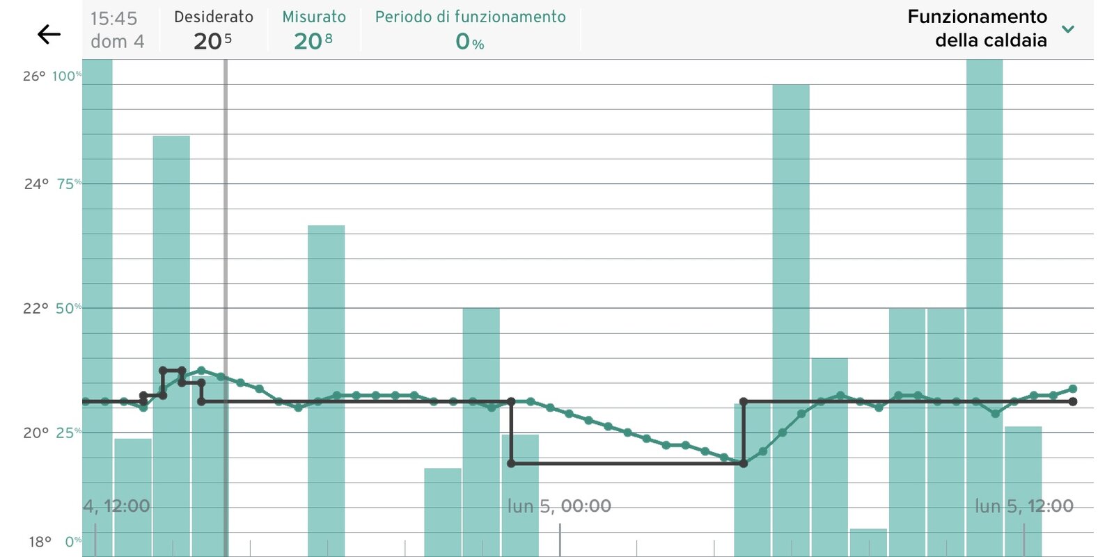

I set 20.5 when in and 19.5 when out and night.
I attach the histogram.
what do you think?

19.5 might be a little high for a set back temperature. Start around 18 and go from there. But it depends on the home and what your prefer.
I try with 19° otherwise T goes too low and the boiler will stay ON longer.
Have you took a look at the graph of the heating operations that I have attached? what do you think?
