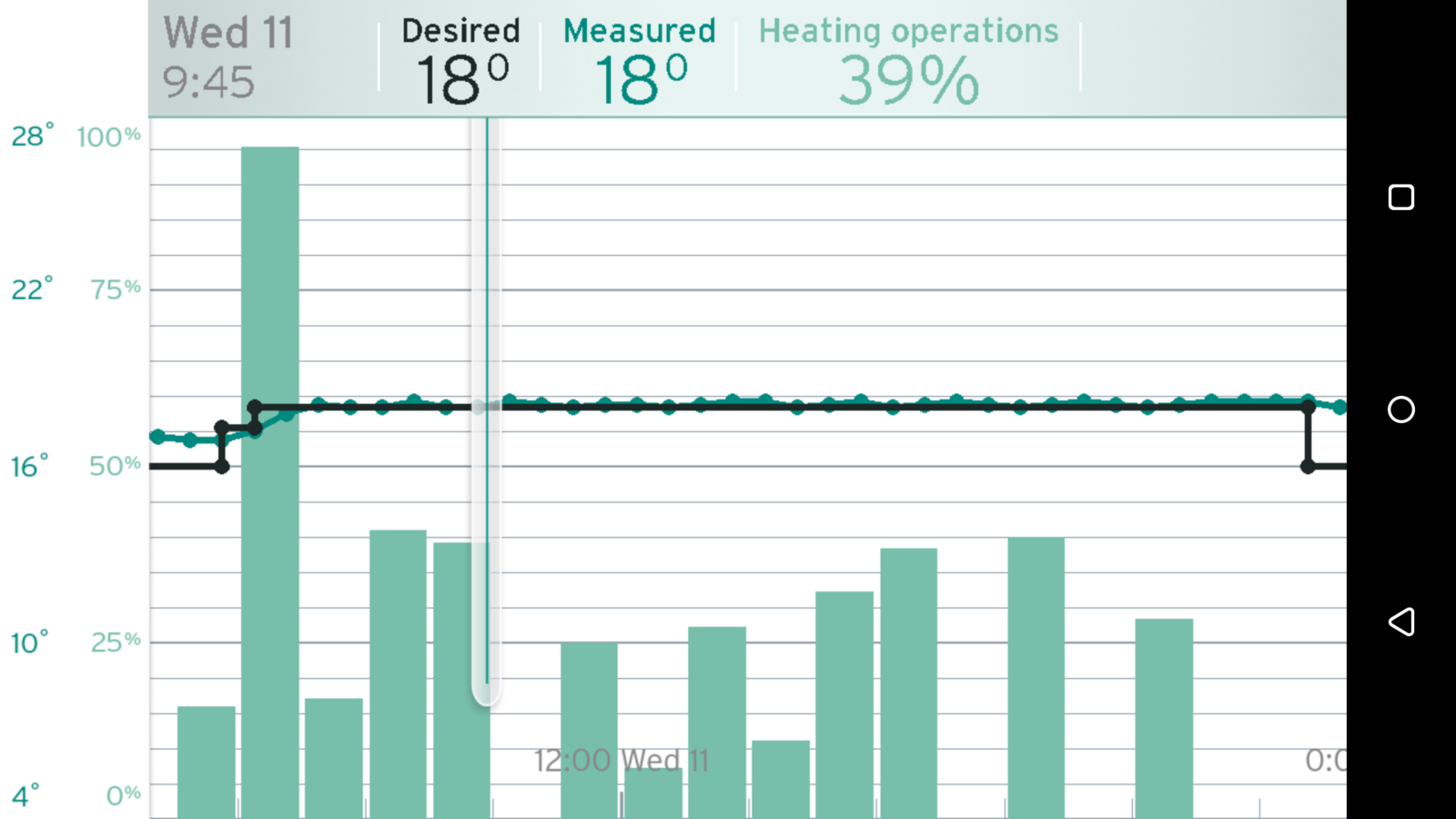

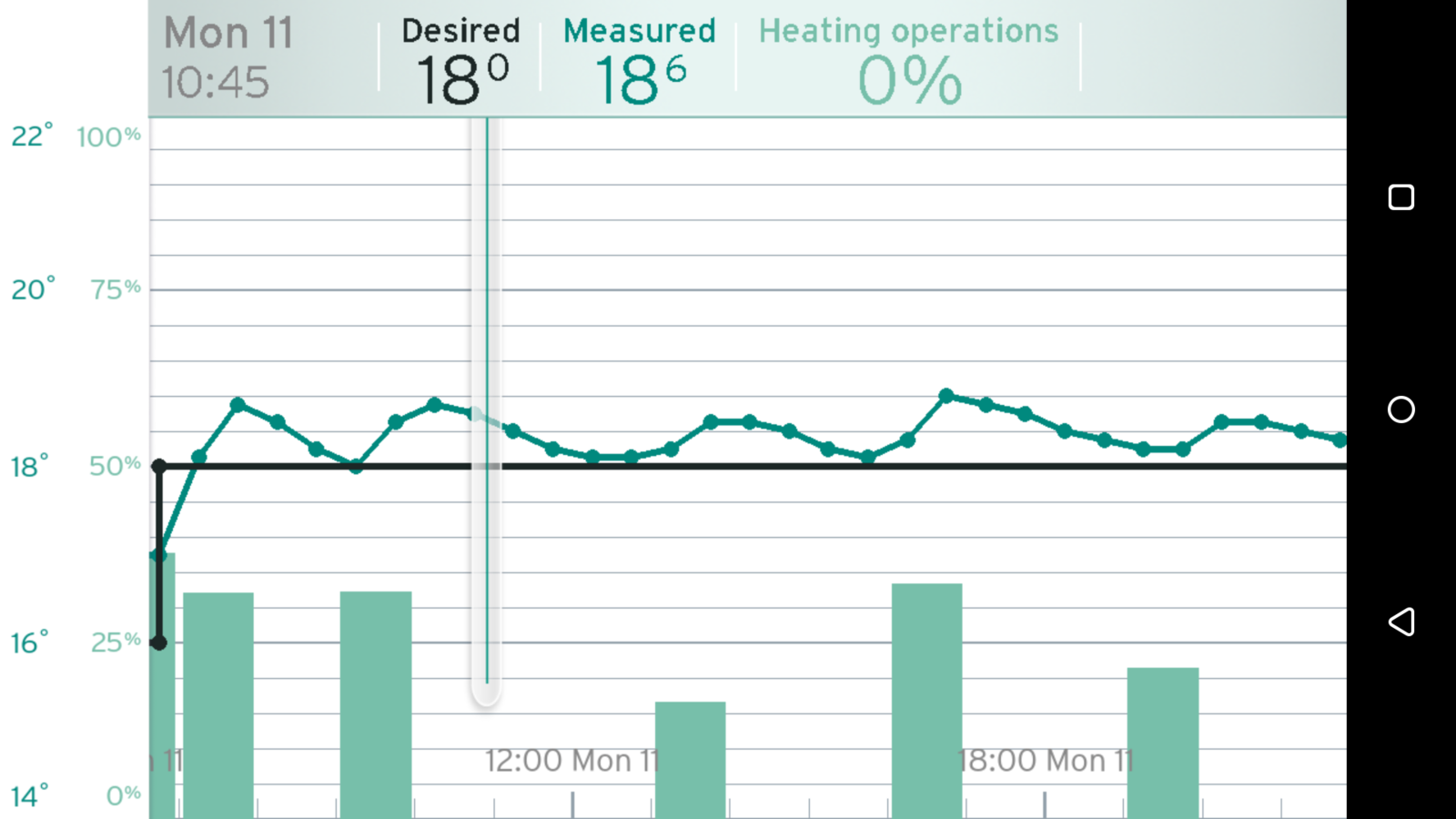

Just to round off this discussion, I thought it might be worth posting a couple of screenshots, showing how our heating system performed before and after replacement of the original vSmart system by our Vaillant "Controls Champion" Andy - our new hero, as it turns out!
The first (which I posted with my original post) shows how the boiler was working frantically to get the radiators really hot, resulting in unpleasant amounts of heat coming from them, and the temperature overshooting the set point by nearly a degree, with fluctuations in the temperature at the thermostat.
The second shows how the system is working now with the replacement vSmart. The boiler comes on more frequently, but maintains a much lower flow temperature, meaning the radiators only provide little more than background heat to keep the temperature almost perfectly constant throughout the day. This is exactly why we bought the vSmart, and it's great to see it finally working as it should. Hopefully it will help the boiler run more efficiently and last much longer (probably until the government tells us we all have to rip out our gas-fired heating and go electric...:rolleyes:).

Since our vSmart was exchanged, it's been matching the setpoint temperature well, overshooting by just 0.2 or 0.3 degrees at most. However, we haven't seen it reduce the flow temperature while the boiler's actually running, which is what we'd expected to happen.
However, now the radiators are just providing gentle background heat, we're not always aware when it's running, so it's harder to monitor exactly what happens with the flow temperature from the start to the finish of each firing cycle. All we know is that the boiler runs more often at lower power, which for us is the main thing.
