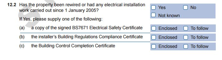

Excuse my silly question, but I’ve rewired my entire house, garage and shed over the 28 years that I have been living here. Last bit if wiring was the kitchen in 2001. Haven’t had any problems but I suppose I always could but what is all this about certificates and, for instance, how would that affect me if I was going to sell my house in say, 5 years time? For all anyone knows, the wiring could be the same as what was here when I moved in in 1990.
No-one, and no future buyer will be concerned, per se, about electrical work done prior to 2005, which is when electrical work came withing the scope of the Building Regulations ("Part P"). The standard conveyancing forms ask if any electrical work has been undertaken prior toafter January 2005 and, if so, asks for relevant certificates/documentation etc. If a potential buyers is concerned about any aspects of the electrical installation, it is for them to have it inspected.

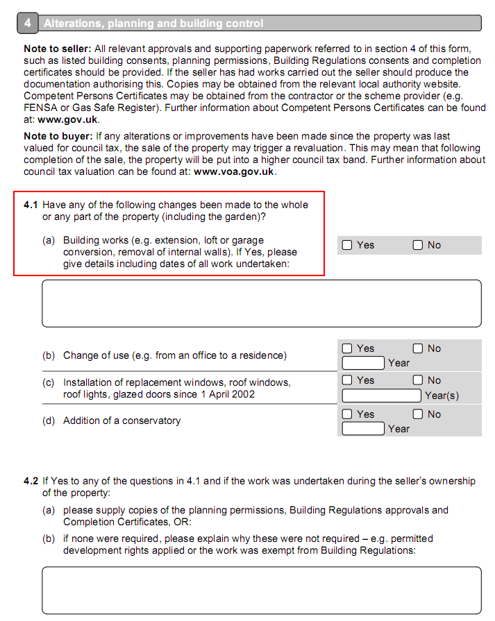

So when did this building control approval come in - I had a builder remove a supporting wall and fit an RSJ in 2001 when the kitchen was made into a kitchen/diner. He didn't notify anyone as far as I know and it hasn't fallen down. Yet!
Although many local authorities had their own by-laws/regulations (and associated 'control') earlier (and Mr Google suggests that Building Regulations and control have existed for several hundred years, particularly in London), I think that the first national Building Regulations (and associated control) came into force in England and Wales around 1966.

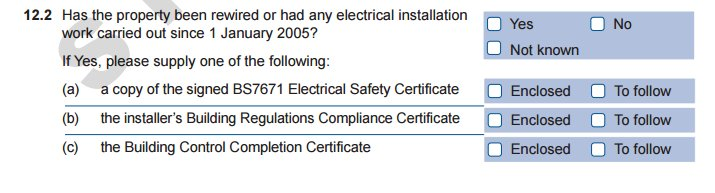

The standard conveyancing forms ask if any electrical work has been undertaken prior to January 2005 and, if so, asks for relevant certificates/documentation etc.
Actually, AFAICT, the "official" form (there may be other customised versions with different wording) only asks:
Implicit in that, I guess, is the expectation that the person filling in the form knows, or is being advised by someone who knows, that there is a specific definition of "building work" in the Building Regulations.
Form TA6 said:
As for what a "BS7671 Electrical Safety Certificate" might be, you'd have to ask the person who designed the form!

The extract from a TA6 I posted was from a licensed conveyancing company ("Conveyancing Direct Ltd"), but it's typical of most I have seen, particularly in relation to the section about electrical work.
In my experience (and I see quite a few of them), it's amazing how many people tick the "Not known" answer to the electrical work question! ... in some cases it probably means that no electrical work has been undertaken during their occupancy, but that that occupancy started after 1/1/2005, but I very much doubt that's always what it means.
