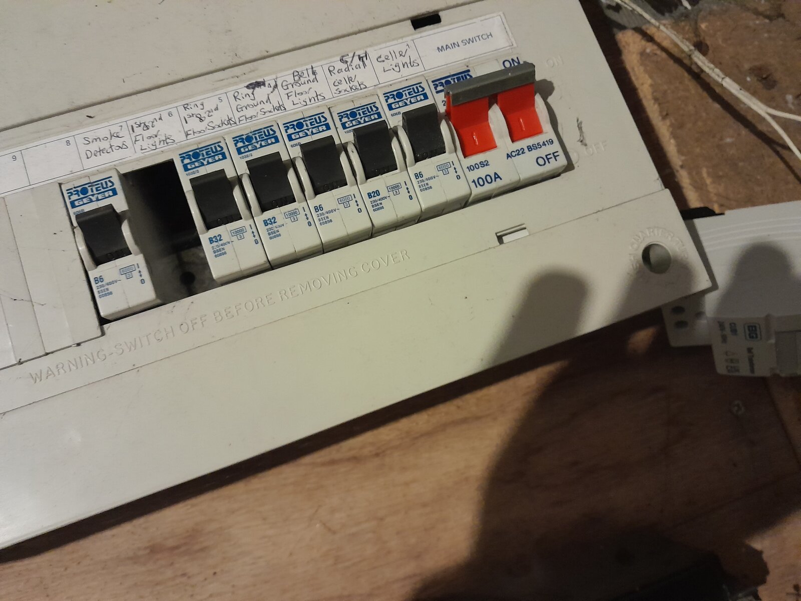

So as I've said my house is a terraced and 4 floors, which includes cellar and attics..
Looks like the 1st and 2nd (attic) floor lights share the same MCB as the cellar floor..no idea when the 1st and 2nd floor MCB was taken out!
so would this give any indication as to the circuits ?
Well there's a C1 straight away - there's an open hole you could stick your finger in and touch live parts.
Probably there was a fault, and someone just moved the live to another breaker rather than try and find a new breaker. As to what feeds what, take anything written on the CU with a pinch of salt and there has clearly been at least one change without updating the labels.
So it’s your house then. On the basis of the photo, and assuming you plan to rent it out, I would recommend a new cu with RCBOs and SPD
Just because 2 cables leave a MCB doesn’t make it 2 circuits. 1 x OCPD = 1 circuit
No I just wrote my house because its just easier saying it , rather than keep repeating my families house etc
I was thinking of just getting an RCD in the existing one. But as you say it maybe wise to just upgrade the whole thing.
Upfront RCDs we’re never a good idea nor are compliant with the regs so RCBOs is the only way forward
And those Proteus boards are absolute carp sold by absolute carp CEF
