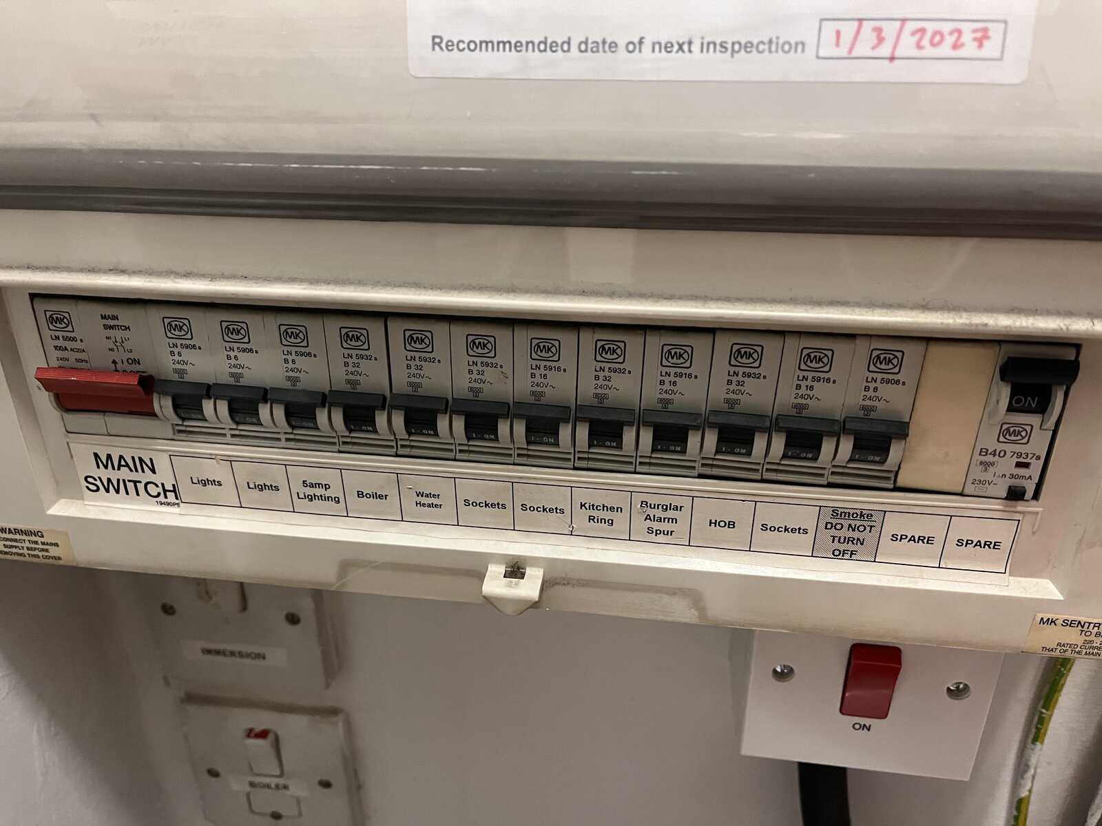

Told I have to replace this relatively modern Consumer Unit
29 Aug 2013
11
Manchester
Just had an EICR done for the first time on my flat, built 2001. The circuits are fine but I was surprised to learn there’s no RCD. Naturally I want one installed regardless of the need to pass the EICR, but the electrician is saying it’s necessary to replace the whole consumer unit (pictured). Can this relatively modern unit really not accept RCDs?

MK changed the design maybe twice since that one, they now no longer make any consumer units, so any parts if ever made would be second hand
You have an RCBO (MCB with built in RCD) controlling the shower circuit.
Now if you can get a dozen of these of the right amperage...
The best thing you can do is change the whole board for a metal one with all RCBOs.
Unfortunately things that seem not all that old, and quite modern, are rapidly becoming very outdated now.
Sad but true.
It's not so much that it "can't accept RCDs" it's that there are a few other problems, which sadly make a consumer unit replacement the most sensible remediation.
The first problem is that manufacturers sometimes do a poor job of maintaining support/compatibility over time. I'm not sure if modern MK stuff is compatible with MK stuff of that board's era. I was under the impression that while the precise designs had changed they were still compatible but I may be wrong.
The second problem, is a lack of space. Having a single RCD for the whole house is not considered a good idea. What is consided the "minimum" these days is a "dual RCD split", where the circuits are split across two RCDs, but that needs more space in the board. Surge protection is also recommended nowadays though not absolutely mandatory. The other options in RCBOs, which provide RCD protection for each individual circuit, it may be possible to fit RCBOs, but by the time you have replaced all the MCBs with RCBOs you aren't far off replacing the whole unit.
The third problem is if you want to be fully compliant with current regs, the consumer unit needs to be made of non-combustible material, yours is not.
It's not necessary to replace the consumer unit, but it certainly makes the most sense. It's unlikely to be feasible to do much more than replace all the MCBs for RCBOs, in which case you may as well replace for a consumer unit compliant with the latest version of BS7671

Thanks everyone, time to get a spanking new unit then. Electrician seemed a decent chap but great to get an independent opinion here.

Some MCB's the opening of the terminal did not force the terminal open, and it was easy to insert the MCB so the bus bar simply pressed against the terminal rather than being securely clamped, this could cause over heating which did cause some fires, but there was a knee jerk reaction by the London Fire Brigade which resulted in the introduction of metal consumer units.

They are interchangeable with each other (However the switches do not align exactly with the old MCB' & RCBO's)
At under £20 each I would be considering simply renewing the MCB's for RCBO's, I would be wary, your existing RCBO says 7937s and new one says H7936s so I would remove the existing and take it with me to get replacements so I can ensure they will fit. They do not look identical
I have found 7937s at £22.19 each both are type AC and really today we should be fitting type A, but I have all type AC.
Maybe some one can tell us if they do interchange? And which one is latest version.
Several things wrong with that CU. Why is the boiler on a 32 amp MCB, 6 would be ample? Likewise I would expect the water heater to be on a 16 amp MCB not 32 and the alarm should be on a 6 amp not 16.

There's not much point in adding two RCCBs when you don't have corresponding neutral bars for them...
I'd have to disagree with @ericmark on replacing the circuit breakers with RCBOs on the existing DB. MK Sentry RCBOs are very expensive in comparison to other (better) makes - i.e. they are dearer even than Hager, certainly in my wholesalers. I had to replace three circuit breakers recently with RCBOs in an MK Sentry. Luckily they had stock of them. But they are also only Type AC, which shouldn't really be fitted in this enlightened day and age.
Deleting the MK Sentry DB and putting something good in (e.g. Hager) has to be where the smart money is.
